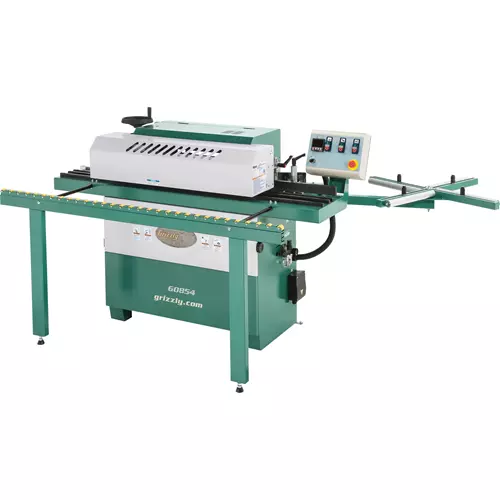

G0854 Compact Automatic Edgebander
A streamlined design means compact and economical edge banding.
Built with small to medium sized shops in mind, the G0854 Compact Automatic Edgebander allows those tight on space to own a machine with a small footprint that delivers huge results.
The compact and simplified design amply rewards you with faster setup times, less maintenance, easier service and a high level of overall reliability.
Designed for the rigors of fast-paced production, this edgebander is flexible enough to handle a wide range of edge banding material (ABS, PVC, laminates, wood tape and wood strips) from 0.5–3.0mm thick on panels ranging anywhere from 1/2" to 1-3/4" thick at a feed speed of 16 feet per minute.
Additional features include a 10-1/2" wide x 69-3/4" long table, automatic belt feed with adjustable rollers, a Teflon-coated glue pot and an adjustable infeed fence for different edgebanding thicknesses.
  • Required power source: 220V, single-phase, min. 15A
  • Feed motor: 3/4 HP, 3.6A
  • Flush trim motor: 3/4 HP, 3.5A
  • Glue spindle motor: 1/3 HP, 1.7A
  • Heating element: 1135W
  • Table size: 10-1/2" W x 69-3/4" L
  • Minimum panel dimensions: 4-3/4" W x 11" L
  • Panel thickness: 1/2"–1-3/4"
  • Tape thickness: 0.5mm–2.0mm
  • Air requirement: 6 SCFM @ 100 PSI
  • Glue pot capacity: 34 oz.
  • Edge banding coil capacity: 31-1/2"
  • Panel feed speed: 16 FPM
  • Footprint: 40" x 23"
  • Overall dimensions: 102-1/2" W x 60-1/2" D x 49-1/2" H
  • Approximate shipping weight: 866 lbs.
  • Automatic belt feed system
  • Two 4" dust ports
  • Five heated elements
  • Adjustable infeed fence
  • Teflon-coated glue pot for easy glue changes
  • Pull-out support arm to handle larger workpieces
  • Powder-coated finish
