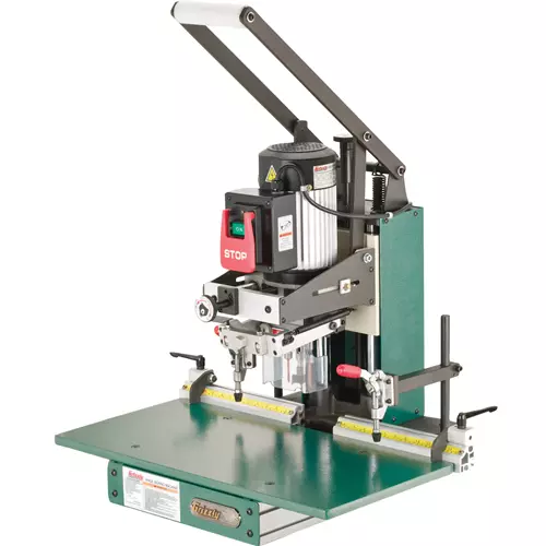

G0718 Hinge Boring Machine
Add precise, professional-quality European-style hinges to your projects.
With a capacity of one piece of wood at a time and a 4" throat depth, this machine is perfect for both small and large projects.
Its high-speed 3440 rpm motor allows you to bore multiple hinges in a fraction of the time it would take to do them by hand, while its adjustable depth stop ensures that every hole is perfectly placed and consistent.
Speed and efficiency aren't the only benefits of the G0718 Hinge Boring Machine. The T23280, T23281, and T23282 boring heads and boring bits are sold separately and required for machine operation. Once installed, these will have a tolerance of +/- 0.2mm to produce clean, accurate holes every time.
In addition to its reliable performance, the G0718 also comes with a number of convenient features. The built-in 4" dust port aids in keeping your work area clean and free of debris.
The adjustable hold-down clamps are used to hold the cabinet door firmly against the table and fence during boring operations.
Safety is also a focus with a switch that can be disabled and locked by inserting a padlock (not included) through the on/start button.
The sturdy construction of the G0718 ensures that it can handle even the toughest woodworking projects and is the perfect addition to any cabinet workshop.
Like all Grizzly machines, the G0718 comes with a 1-year warranty which covers parts and assures the unit is free from factory defects.
The G0718 manual was written by our U.S. based Technical Documentation Department and is packed with useful information. The complete and easy-to-read manual makes it easier to assemble and maintain your machine.
The Grizzly Customer Service and Technical Support Teams are U.S. based. Parts for the boring machine may be available online and shipped from the Grizzly parts warehouse in Springfield, MO.
  • Motor: 1 HP, 110V/220V (prewired 110V), single-phase, 10A/5A
  • Table size: 28" wide x 13-3/4" deep
  • Maximum throat: 4"
  • Fence length: 12" (x 2), plus 28" left extension
  • Stroke: 4"
  • Stroke operation: Manual
  • Dust port: 4"
  • Footprint: 22-1/2" W x 15-1/2" D
  • Overall dimensions: 29" W x 25" D x 36-5/8" H
  • Approximate shipping weight: 198 lbs.
  • Hinge alignment swing arm
  • Depth stop adjustment
  • Lateral adjustment
  • Two fence flip stops
  • Two toggle hold-down clamps
  • Fence extension
  • SUJ-2 high carbon anti-friction steel slide shafts
  • See-through guard
  • Interchangeable boring heads can be installed (sold separately)
