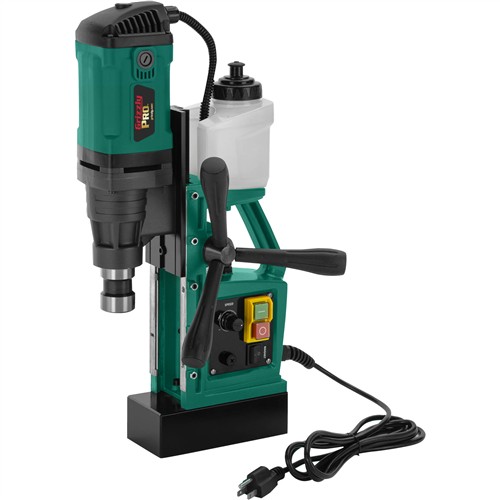

Grizzly PRO T30943 1-3/8" Magnetic Drill
A consistent, accurate, and powerful magnetic drill.
The Grizzly T30943 1-3/8" Magnetic Drill is designed for tough, industrial-level use that will keep cutting on the most demanding of jobs. When it comes to drilling tough metals in hard-to-access locations, you can't beat the speed and precision of a magnetic or mag drill.
With 3300 lbs. of force when turned on, the magnetic base of the T30943 adheres to ferrous metal surfaces and ensures consistent drilling. The built-in level will assist accurate drilling. The mag drill can be positioned to drill horizontally, vertically or overhead, just be sure to secure the drill in the event of a power loss.
The 1-3/4 HP motor smoothly powers the variable-speed drill press from 100 - 830 RPM. The T30943 comes equipped with a 3/4" Weldon tool holder to give users access to the broadest selection of annular cutters and twist drills on the market. An included 1/2"-20 adapter for the drill chuck opens the options even further.
Coupled with a spindle stroke of 6", a gravity-fed coolant system and a heavy-duty case for hauling and storage, these mag drills are consistent, accurate and powerful.
Like all Grizzly mag drills, the T30943 comes with a 1-year warranty which covers parts and assures the unit is free from factory defects. (Consumables are not covered by the warranty.)
The T30943 manual was written by our U.S. based Technical Documentation Department and is packed with useful information.
The Grizzly Customer Service and Technical Support Teams are U.S. based. Parts for the mag drill may be available online and shipped from the Grizzly parts warehouse in Springfield, MO.
  • Motor: 1-3/4 HP, 110V, single-phase, 11.7A
  • Spindle bore: 3/4"
  • Spindle stroke: 6"
  • Spindle speed: Variable, 100–830 RPM
  • Max. distance spindle to table: 7"
  • Cutter shank diameter: 3/4" Weldon
  • Max. carbide annular cutter diameter: 1-3/8"
  • Max. HSS annular cutter diameter: 1-3/8"
  • Max. twist drill diameter: 3/8"
  • Magnetic holding force: 3300 lbs.
  • Magnetic base dimensions: 6 1/2" x 3 1/4"
  • Min. workpiece thickness: 3/8"
  • Coolant tank capacity: 18 oz.
  • Overall dimensions: 7" W x 10" D x 20" H
  • Approximate shipping weight: 33 lbs.
  • Built-in level
  • Gravity-fed coolant system
  • Heavy-duty storage case
  • Includes Weldon 3/4" to 1/2"–20 adapter for drill chuck
  • Includes 1/16"-1/2" drill chuck
  • Includes replacement fuses
