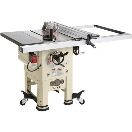

W1837 10" 2 HP Open-Stand Hybrid Table Saw
The best features of the cabinet and contractor saws combined into a hybrid.
The Shop Fox W1837 10" Open Stand Hybrid Table Saw was named as one of the Best Hybrid Table Saws for Contractors or DIY Projects by Tool Digest.
The biggest perk was that the saw has a single-phase motor that comes prewired to operate on a 20A circuit. This is a big deal for amateur and novice woodworker that don’t want the added expense of hiring an electrician to add an outlet in the garage or shop.
Thanks to the hybrid design, cutting capacities are not diminished and stand toe-to-toe with the most expensive cabinet saws in the market. Like a contractor-style saw, its low weight and built-in mobile base allow it to be easily moved where you need it.
The enclosed steel upper-stand has a bottom-facing 4" dust port allowing for maximum dust containment.
The fence features easy lift-off and adjustability to create a simpler and more enjoyable user experience.
The W1837 features cabinet-mounted cast-iron trunnions to absorb vibration and guarantee the appropriate miter slot and blade-to-fence alignment. The table is cast-iron and has been precision-ground for a smooth cutting action.
The serpentine belt and pulley system lends to a smoother and quieter operation with better power transfer than a standard V-belt drive system.
This hybrid saw is sure to be the envy at any shop or worksite.
