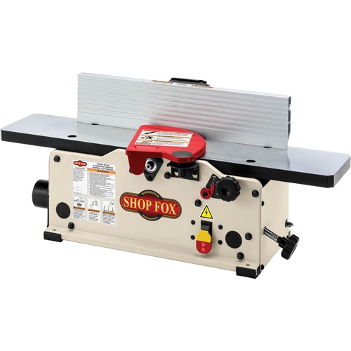

Shop Fox W1876 - 6" Benchtop Jointer w/ Spiral-Type Cutterhead

Shop Fox W1876 6" x 30" Benchtop Jointer with Spiral-Type Cutterhead
Performance jointing within a space-saving footprint.
This benchtop jointer will square up edges with the spiral-type cutterhead with HSS indexable inserts.
A spiral-type cutterhead allows smoother finishes, quieter operation, and less maintenance compared with straight-knife cutterheads.
The 12 high-speed steel (HSS) inserts sit square to the axis of the cutterhead, with the cutting edges perpendicular to the workpiece. HSS has been heat treated for hardness and wear resistance, which keeps a sharp edge longer than other carbon steels.
Each two-sided insert can each be rotated once to expose a new sharp edge.
The knob-adjustable infeed table with lock provides ultra-precision cutting depth adjustments.
The W1876 also features an inch and metric cut depth indicator and an east-to-adjust extruded-aluminum fence.
You won't find a more feature-packed 6" benchtop jointer anywhere else.

  • Motor: 1-1/2 HP, 120V, single-phase, 10A
  • Maximum depth of cut: 1/8"
  • Maximum width of cut: 6"
  • Bevel jointing: 0–45°
  • Cutterhead type: 6-Row spiral-type
  • Cutterhead diameter: 2"
  • Cutterhead speed: 11,000 RPM
  • Cutter insert type: Indexable HSS
  • Cutter insert size: 14mm x 14mm x 2mm
  • Number of inserts: 12
  • Table size: 30" x 6-1/4"
  • Dust port size: 2-1/2"
  • Dimensions: 30" x 17-1/2" x 13-1/2"
  • Approximate shipping weight: 44 lbs.
  • Spiral-type cutterhead with 12 indexable HSS inserts
  • 2-1/2" dust port
  • Cast aluminum infeed and outfeed tables
  • Infeed table height adjustment lock
