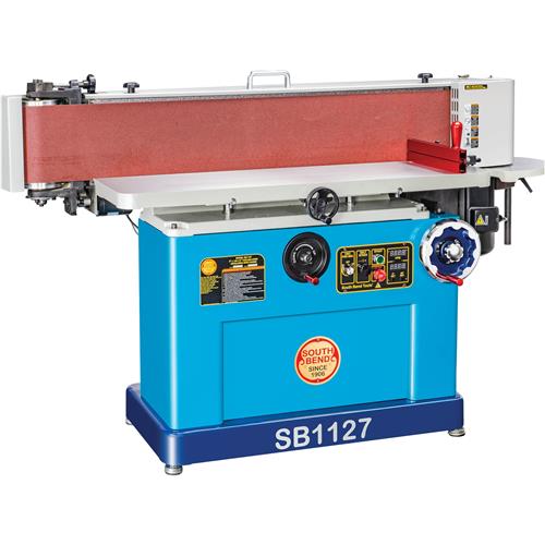

SB1127 Variable-Speed Oscillating Edge Sander
The power of professional sanding with an industrial-grade machine designed for exceptional results.
Whether you're refining imperfections, contouring surfaces, or edge sanding doors, your trust in your equipment matters most.
The South Bend SB1127 is engineered to meet the demands of industrial-level use, making your sanding tasks effortless.
What sets it apart:
  • Effortless Sanding: Master contours, bevels, and edges without fighting gravity.
  • Control your project with a variable speed belt.
  • Zero guesswork with exact platen tilt control.
  • Precision at a Glance: Digital readouts for belt speed and platen tilt keep you in control.
  • Spacious Work Surface: A nearly four-foot-long, precision-ground cast-iron table and graphite-coated platen provide ample space.
  • Versatile Contour Sanding: Enjoy 7" of vertical travel with the contour sanding table for rounded edges.
  • Pro-Quality Results: Whether you're a novice or a pro, consistently achieve professional outcomes.
Under the hood:
  • Robust 3 HP Motor: Powers the 9" x 138-1/2" belt with variable speeds (1100-4250 feet per minute) and smooth 1/4" to 3/8" oscillations for improved workpiece finish and longer belt life.
  • Variable Frequency Drive: VFD for smooth, high-torque variable speed using single-phase power.
  • Easy Adjustments: The height handwheel ensures straightforward adjustments and maximizes sanding surface utilization.
  • Quick Belt Changes: Thanks to the quick-release belt tension lever, changing belts is a breeze.
Plus, rest easy with the South Bend 2-year warranty, offering peace of mind with your purchase.
The SB1127 manual was written by our U.S.-based Technical Documentation Department and is packed with useful information.
  • Required power source: 230V, single-phase, min. 20A circuit
  • Motor: 3 HP, 230V
  • Sanding belt size: 9" x 138-1/2"
  • Sanding belt speed: 1100–4250 FPM
  • Oscillations: 1/4"–3/8"
  • Platen size and type: 10" x 47-5/8", graphite-coated
  • Platen tilt: 0–45°
  • Main table size: 13" W x 46" L
  • Main table vertical travel: 7-3/8"
  • Auxiliary table size: 12" W x 17-1/4" L
  • Auxiliary table vertical travel: 7"
  • Footprint: 39" x 20"
  • Overall dimensions: 76" W x 40" D x 46" H
  • Approximate shipping weight: 811 lbs.
  • 2-year limited warranty
  • Digital readouts for sanding belt speed and platen tilt
  • Quick-release belt lever
  • Graphite-coated platen
  • Sanding belt oscillates at 30–50 cycles per minute
  • Miter stop has adjustable anodized aluminum fence
  • Miter stop adjusts 60° L/R
  • U.S.-based customer service and technical support
