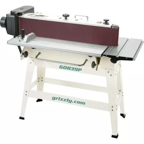

G0839P 6" x 79" Edge Sander
Shifting your expectations of what an edge sander should be.
The pivoting 1-1/2 HP motor and platen design makes horizontal-to-vertical position changes of the G0839P 6" x 79" Edge Sander a breeze.
With 3-1/2" of vertical edge-table travel and the ability to tilt both edge-table and end-table from 0-45°, you'll have all the angles covered.
3/4" T-slots in the edge table and end table can be used in combination with the included miter gauge to support your workpiece.
The 6" x 79" belt rotates around a 2-3/4" end roller for tight radius sanding.
Belt tracking and tension are easily adjustable with a conveniently located lever and control knob.
A full range of replacement belts are available.
  • Motor: 1-1/2 HP, 110V/220V (prewired 110V), single-phase, 14A/7A
  • Sanding belt speed: 2600 FPM
  • Sanding belt size: 6" x 79"
  • Sanding belt tilt: 90°
  • Edge table dimensions: 9-3/8" W x 31-1/4" L
  • Edge table travel: 3-1/2"
  • Edge and end table tilt: 0-45°
  • End table: 9-3/8" W x 20-5/8" L
  • Graphite-coated platen: 5-7/8" x 32-1/4"
  • Steel idler roller: 2-3/4"
  • Footprint: 37" W x 16-1/2" D
  • Overall dimensions: 51" W x 23-1/2" D x 40" H
  • Approximate shipping weight: 199 lbs.
  • Sanding surface tilts vertical to horizontal
  • Edge table tilt range 0 to 45°
  • End table tilt range 0 to 45°
  • 90° sanding belt tilt
  • Quick belt release
  • Conveniently located belt tracking adjustment
  • 3/4" T-slots in edge table and end table
  • Miter gauge
  • 4" Dust port
