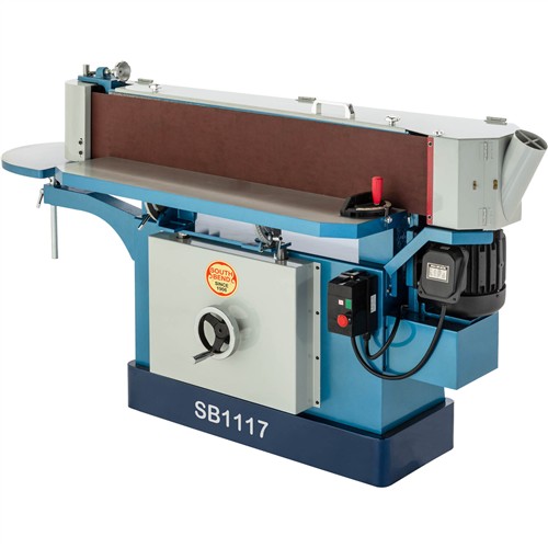

SB1117 9" x 138-1/2" Oscillating Edge Sander
Get professional results with an industrial-grade oscillating sander.
Whether edge sanding doors, smoothing contours, or cleaning up imperfections, you need to trust your machinery to perform at the highest level.
The South Bend SB1117 9" x 138-1/2" Oscillating Edge Sander is a large-capacity sander built to handle the rigors of industrial-level use.
Effortlessly sand contours, bevels, and edges with ease.
The precision-ground cast aluminum table and graphite-coated platen span nearly four feet!
A contour sanding table with 8" of vertical travel allows for sanding rounded edges.
Both tables tilt down 45° to provide bevel sanding with a high level of precision and control.
Whether you're a beginner or a seasoned pro, the SB1117 helps you achieve professional results every time.
A powerful 3 HP motor drives the 9" x 138-1/2" belt at 4120 feet per minute with smooth 1/4" oscillations that improve the finish and prolong belt life.
The height handwheel allows for easy and precise adjustment of the table which maximizes use of the sanding belt against the platen.
Belt changes are fast and easy with the quick-release belt tension lever and roller adjustment features, allowing you more time to focus on creating your best work. A full range of replacement belts are available.
The SB1117 manual was written by our U.S.-based Technical Documentation Department and is packed with useful information. The complete and easy-to-read manual makes it easier to assemble and maintain your sander.
  • Motor: 3 HP, 220V, single-phase, 15A
  • Sanding belt size: 9" x 138-1/2"
  • Sanding belt speed: 4120 FPM
  • Oscillations: 1/4"
  • Platen size and type: 9-1/2" x 47-1/2", graphite-coated
  • Main table size: 11-3/4" W x 47-3/4" L x 1-5/8" T
  • Main table tilt: 0–45°
  • Main table vertical travel: 5-1/8"
  • Auxiliary table size: 13" W x 18" L x 1-1/4" T
  • Auxiliary table vertical travel: 8"
  • Dust port sizes: (2) 4"
  • Footprint: 19" x 44-1/2"
  • Overall dimensions: 82-1/2" W x 26-1/2" D x 46-1/2" H
  • Approximate shipping weight: 839 lbs.
  • 1/4" belt oscillation for smoother and more consistent finish
  • End guards swing away for edge sanding long boards
  • Time-saving quick-release belt lever
  • Conveniently located belt tracking and tension adjustment
  • Two large and heavy-duty sanding tables
  • Table height handwheel for maximum use of the sanding belt
