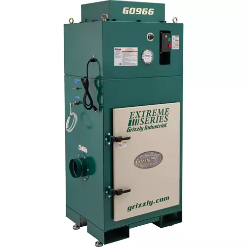

G0966 1-1/2 HP Metal Dust Collector with Spark Deflector
Improve air quality and enhance workplace safety with metal dust collection.
This heavy-duty 2-stage HEPA metal dust collector captures dry metal, chips, swarf, dust, and particles down to 0.2 microns for a safer, more productive shop environment.
Collecting metal dust offers extensive benefits, including a cleaner workspace, enhanced equipment and product protection, and improved overall air quality.
Flame-resistant canister filter The canister filter protects you from welding and cutting slag flare-ups while providing the essential first step of filtration. This filter provides 2-micron filtration at 95%.
HEPA filtration at 99.99% efficiency The MERV-17 HEPA filter provides filtration down to 0.3 micron so that you can breathe easy! Complete your metalworking projects with confidence in the quality of your shop air.
Powerful motor This unit features a 1-1/2 motor providing high 884 CFM air volume. The result–extreme metal dust collection!
Take the guesswork out of filter replacement A built-in vacuum pressure gauge indicates when filter cleaning or replacement is needed. No guesswork involved!
Pneumatic cleaning process The cleaning process is simple. The air pulse button allows for pneumatic cleaning, and an industrial quick coupler plug connection for easy use.
Simple dust disposal The removable dust tray makes it easy to dispose of the metal dust.
Works on standard 120V power This machine runs on 120V single-phase power. You don’t need a 220V connection to get the metal dust collection you need.
Sturdy construction for years of use The steel body and powder-coated finish provide a solid framework to keep the machine up and running for years. And at 513 pounds, this dust collector is sturdy enough to withstand extensive shop wear and tear.
