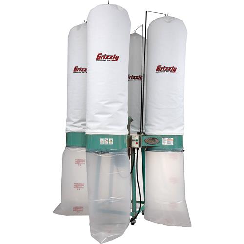

G0673 10 HP Industrial Dust Collector
Controlling dust in a large shop can be a challenging task, but not for this machine.
The G0673 10 HP Industrial Dust Collector features 5360 CFM air suction capacity and a 17.9" static pressure rating for massive amounts of collection.
It can be operated as either a stationary or mobile unit. There are advantages and disadvantages to both set-ups. The advantage of the mobile system is eliminating the cost of many ducts and fittings. On the other hand, the stationary system is more versatile and convenient.
Four heavy-duty plastic collection bags (with a total of 48 cubic feet of storage capacity) will easily allow you to collect from the biggest chip and dust producing machines all day long without emptying.
The four upper 2.5-micron bag filters top off the machine and minimize the dust.
The 5-port inlet is included for quick and economical dust collection.
The G0673 manual was written by our U.S.-based Technical Documentation Department and is packed with useful information.
The complete and easy-to-read manual makes it easier to assemble and maintain your dust collector.
*This machine is prewired for 220V. We can rewire to 440V in a few days’ time for a fee. Please contact Grizzly Technical Support at (570) 546-9663 before placing your order.
