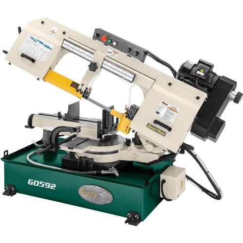

G0592 10" x 18" 2 HP Metal-Cutting Bandsaw
A high-performance bandsaw to maximize your metalworking operations.
The full-featured G0592 Metal-Cutting Bandsaw includes large cutting capacities for both round and rectangular stock.
The swivel base cuts miters from 60-degrees to the left to 45-degrees to the right.
It has variable blade control ranging from 98 to 394 feet per minute. Simply rotate the speed adjustment knob to dial in your speed.
The speed at which the blade will cut through a workpiece is controlled by blade type, feed rate, and feed pressure. The feed rate is controlled by two knobs on the control panel.
The vise can be positioned for cutting on both sides of the vise. It has a ratcheting type leadscrew that allows for fast jaw adjustments.
The G0592 has a built-in coolant system that extends the life of your bandsaw blades by lowering the temperature of the blade and workpiece. It also has a convenient spray gun to help you clean the saw after use.
You'll have a tough time finding a better metal-cutting bandsaw in this size range, with these features, at this price.
For a full range of replacement blades for the G0592, shop here.
  • Motor: 2 HP, 220V, single phase, 15A
  • Blade size: 132" x 1" x 2/3 VP TPI
  • Blade speeds: Variable, 98–394 FPM
  • Cutting capacities:
    • 90° Round: 10"
    • 90° Rectangular: 9-1/2" x 18"
    • 45° Round: 10"
    • 45° Rectangular: 10" x 11"
    • 60° Round: 8"
    • 60° Rectangular: 5" x 8"
  • Head swivel: 60° L/45° R
  • Vise jaw height: 5"
  • Vise depth: 7-1/2"
  • Floor to table height: 20"
  • Footprint: 28-1/2" x 45"
  • Overall dimensions: 72-1/2" W x 32" D x 58" H
  • Approximate shipping weight: 967 lbs.
  • Swivel base with degree scale
  • Heavy-duty all steel, one-piece base
  • Adjustable hydraulic downfeed
  • Variable-speed blade control
  • 4-Gallon coolant tank
  • Automatic shut off
  • Adjustable feed rate
  • Quick-release vise
  • Wash down hose and spray gun
  • Adjustable positive stops for head angle
