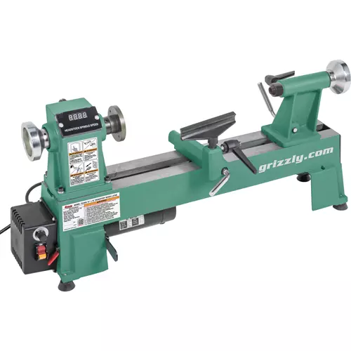

Grizzly T25926 - 10" x 18" Variable-Speed Benchtop Wood Lathe
4.8 (44)
$500.00
T25926 10" x 18" Variable-Speed Benchtop Wood Lathe
Everything you need in a benchtop lathe.
The Grizzly T25926 10" x 18" Variable-Speed Wood Lathe comes with a standard 1/2 HP motor.
The variable speeds from 650–3800 RPM give you plenty of power and flexibility for any project. You can read the exact RPM on the digital readout display.
Heavy-duty cast-iron construction provides plenty of mass and stability for wood turning.
Bolt up to the 3-1/8" faceplate and turn plates and bowls up to 10" wide and spindles up to 18" long.
Add the optional T27327 Bed Extension and you've got a full-size lathe that can turn up to 40" between centers.
The manual for the T25926 was written by our U.S.-based Documentation Department and is packed with useful information. The complete and easy-to-read manual provides detailed instructions on how to assemble and maintain your lathe.
  • Motor: 1/2 HP, 110V, single-phase, 3.4A
  • Swing over bed: 10"
  • Swing over tool rest base: 7-1/4"
  • Distance between centers: 18"
  • Spindle speeds: Variable, 650–3800 RPM
  • Spindle threads: 1" x 8 TPI
  • Spindle bore: 3/8"
  • Spindle taper: MT#2
  • Tailstock taper: MT#2
  • Tool rest width: 5-3/4"
  • Tool rest post diameter: 5/8"
  • Footprint: 8" x 30"
  • Overall dimensions: 37-3/4" W x 12" D x 15" H
  • Approximate shipping weight: 78 lbs.
  • Spindle speed DRO
  • Quick-release on rest and tailstock for easy adjustment
  • Solid cast-iron construction
  • Includes 3-1/8" faceplate
  • Includes MT#2 live and spur centers
  • Includes 5-3/4" tool rest
  • 1-year limited warranty
