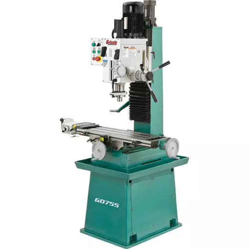

G0755 10" x 32" 2 HP HD Mill/Drill w/ Stand & Power Feed
Taking mill drills to the next level with impressive features.
The G0755 10" x 32" 2 HP HD Mill/Drill is a free-standing mill/drill that strikes a great balance between being heavy-duty and high-precision.
The spindle is equipped with precision P5 spindle bearings and is driven by an oil-bath-lubricated and gear-driven head. The spindle is fully reversible and features both coarse and fine downfeed controls. The six spindle speeds range from 90–1970 RPM and are controlled by convenient gear-change levers.
The head tilts 90° left, 45° right, and moves in the Z-axis along precision dovetailed ways—with both manual and powered elevation control. The table also features both manual and powered X-axis control, but with a manually-controlled Y-axis.
