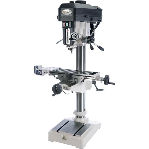

G0810 16" Drill Press with Cross-Slide Table and Power Feed
An industrial drill press with precision controls for producing heavy-duty work.
The G0810 16" Drill Press features a power feed for X-axis movement and a cross slide table to help you produce high-precision work.
With 14-7/8" of X-axis travel and 7" of Y-axis travel, the G0810 provides easy adjustability with both the X and Y-axis.
The twelve spindle speeds range from 150–3000 RPM based on v-belt positioning. The low RPM speed is vital to drilling metal.
Set the depth stop and use the coarse downfeed for fast production drilling, or switch over to the fine-downfeed handwheel for precision control up or down along the generous 5-1/8" spindle travel.
A good drill press starts from the ground up, and this one offers the foundation you need with a thick, heavy-cast 26" x 19" base and beefed up 4-1/2" column for rigidity and stability that you can count on.
