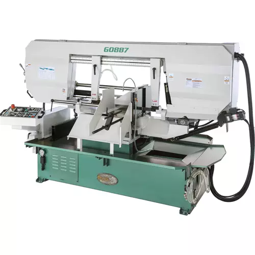

G0887 20" x 26" 5 HP Mitering Industrial Metal-Cutting Bandsaw
A dual-mitering metal-cutting bandsaw for all-day use in production shops and industrial facilities.
The G0887 Metal-Cutting Bandsaw minimizes material size constraints with its massive 20" x 26" cutting capacity.
This fully hydraulic operated bandsaw features a powerful 5 HP, 3-phase motor with variable-speed adjustment from 106–315 FPM.
The G0887 truly is industrial-duty with its 232" blade and the ability to cut miters from -60° to +60°.
The sliding vise and hydraulically-controlled angle adjustment features allow you to load the largest of material and make cuts without the need of rotating or removing the workpiece from the machine.
The blade tension gauge, 10-gallon coolant system, and a programmable height stop are just some of the outstanding convenience features of this saw.
