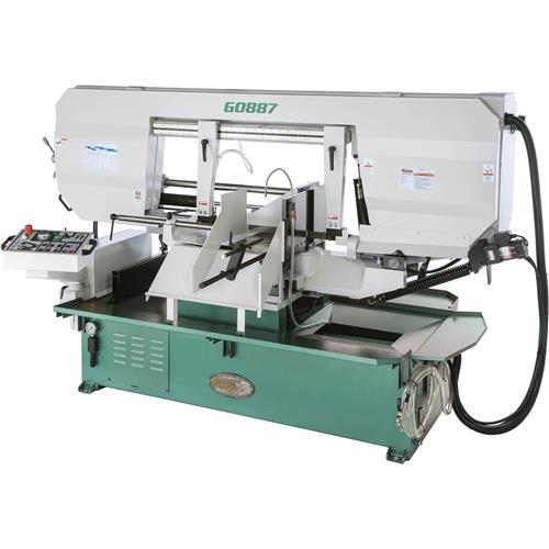

G0887 20" x 26" 5 HP Mitering Industrial Metal-Cutting Bandsaw
A dual-mitering metal-cutting bandsaw for all-day use in production shops and industrial facilities.
The G0887 Metal-Cutting Bandsaw minimizes material size constraints with its massive 20" x 26" cutting capacity.
This fully hydraulic operated bandsaw features a powerful 5 HP, 3-phase motor with variable-speed adjustment from 106–315 FPM.
The G0887 truly is industrial-duty with its 232" blade and the ability to cut miters from -60° to +60°.
The sliding vise and hydraulically-controlled angle adjustment features allow you to load the largest of material and make cuts without the need of rotating or removing the workpiece from the machine.
The blade tension gauge, 10-gallon coolant system, and a programmable height stop are just some of the outstanding convenience features of this saw.
For a full range of replacement blades for the G0887, shop here.
  • Main Motor: 5HP, 220V, 3-phase, 15.2A
  • Hydraulic Pump Motor: 2 HP, 220V, 3-phase, 5.7A
  • Table motor: 1 HP, 220V, 3-phase, 3.3A
  • Coolant Pump: 1/8 HP, 220V, 3-phase, 0.3A
  • Blade brush motor: 60W, 220V, 3-phase, 0.4A
  • Blade size: 232" x 1-5/8"
  • Blade speed: 106–315 FPM
  • Cutting capacities:
    • 90° Round: 20"
    • 90° Rectangular: 20" x 25-7/8"
    • ±45° Round: Round: 20"
    • ±45° Round: Rectangular: 20" x 20"
    • ±60° Round: 14-7/8"
    • ±60° Rectangular 14" x 14"
  • Footprint: 77" x 36"
  • Overall dimensions: 119" W x 63" D x 70" H
  • Approximate shipping weight: 3960 lbs.
  • Dual swivel cutting miters up to 60°
  • Sliding vise with material outfeed support
  • One-piece stand with swivel control box for convenient operation
  • High-efficiency gear drive system provides quick-speed changes
  • Hydraulic cylinder and buffer spring enhance cutting stability
  • Digitally controlled headstock travel speeds up repetitive cuts
  • Electric shut off system and alarm for the ultimate in safety
  • Cleaning hose and nozzle and easy access chip tray for smooth clean ups
  • Self-propelled blade brush extends life of blade
  • 10-gallon coolant system
