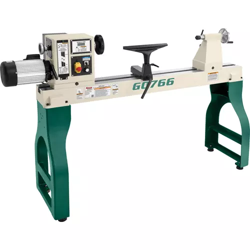

G0766 22" x 42" Variable-Speed Wood Lathe
A perfect wood lathe for serious woodturners.
The G0766 22" x 42" Variable-Speed Wood Lathe is for serious those who want to turn large bowls, furniture pieces, and other large-diameter projects.
With 22" of swing, a heavy-duty 1-1/4" x 8 TPI RH spindle, electronic variable speed control and a 3 HP, 3-phase motor that runs off single-phase power using a variable-frequency drive, this lathe has plenty of clearance and torque to easily rough out big projects at low speeds.
The heavy-duty cast-iron bed and stand make this lathe extremely stable and the headstock can be positioned anywhere along the bed, giving you a wide range of control and flexibility with your projects.
ETL certified
  • Required power source: 240V, single-phase, min. 20A circuit
  • Motor: 3 HP, 240V
  • Swing over bed: 22"
  • Swing over tool rest base: 18"
  • Distance between centers: 42"
  • Spindle speed: Variable, 100–3200 RPM
  • Spindle threads: 1-1/4" x 8 TPI RH
  • Spindle taper: MT#2
  • Tailstock taper: MT#2
  • Tool rest width: 14"
  • Tool rest post diameter: 1"
  • Footprint: 65-1/2" x 20"
  • Overall dimensions: 81" x W 23" D x 49-1/2" H
  • Approximate shipping weight: 524 lbs.
  • 100–1200 RPM low-speed range
  • 330–3200 RPM high-speed range
  • Digital readout for spindle RPM
  • Headstock positions anywhere along the bed
  • 10° spindle indexing
  • Tailstock, headstock, and tool rest support have lever-action cam locks for quick positioning
  • Forward/reverse spindle control
  • 4-1/4" tailstock barrel travel
  • Includes spur center, cupped live center, knock-out tool, tool rest, 6" faceplate and indexing pin
