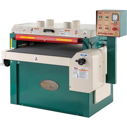

G0450 37" 15 HP 3-Phase Drum Sander
A three-phase drum sander for industrial sanding.
Built for production environments, the G0450 37" 15 HP Drum Sander features industrial-quality conveyor belts and dual 6" sanding drums.
The dual drum setup allows you to place different grits of sandpaper on each drum; cutting your sanding time in half.
Changing the 6"-wide by-138" long sandpaper is easy and straightforward. Simply remove the top cover for unobstructed access. A wide selection of replacement sanding rolls, from coarse grits for fast material removal to ultra-fine grits for a flawless, high-grit finish.
Sand stock up to 36-1/2" wide and 4" thick with variable-speed feed control and the economy of spiral-wrapped 6" wide sandpaper rolls.
When the G0450 is wired for 480V, it will operate on a 30A circuit!
With the variable-speed conveyor, you can dial in the perfect finish for each job between 6–18 FPM.
The amp load meter indicates the combined amperage draw of both motors, allowing you to monitor them and prevent damage to them.
The depth scale indicates the thickness the workpiece will be after it has been sanded.
Also features four 4" dust ports to maximize dust collection, easy access to sanding drums, emergency stop for safety, solid steel construction, independent motor control, and massive power.
The G0450 manual was written by our U.S.-based Technical Documentation Department and is packed with useful information.
CSA certified
*This machine is prewired for 240V. We can rewire to 480V in a few days’ time for a fee. Please contact Grizzly Technical Support at (570) 546-9663 before placing your order.
  • Sanding drum motor: 15 HP, 240V/480V* (prewired 240V), 3-phase, 41.3A/20.65A
  • Conveyor motor: 1/3 HP
  • Minimum circuit size: 60A @ 240V, 30A @ 480V
  • Maximum board dimensions: 36-1/2" W x 4" T
  • Minimum board dimensions: 9" L x 1/16" H
  • Surface speed of drums: 2800 FPM
  • Conveyor feed rate: Variable, 6–18 FPM
  • Sanding drums: 2, steel/rubber-coated
  • Sandpaper size: 6" x 138"
  • Overall Dimensions: 68" W x 50-1/2" D x 49" H
  • Approximate shipping weight: 1382 lbs.
  • Spring-loaded sanding belt tension/sandpaper
  • Industrial-duty rubber conveyor belt
  • Four 4" dust ports
  • Variable-speed conveyor
  • 6" steel/rubber-coated sanding drums
  • Easy access control panel with load meter
  • Hinged hood with gas struts for easy drum access
  • State-of-the-art computer-balanced drums
  • 1-year limited warranty
