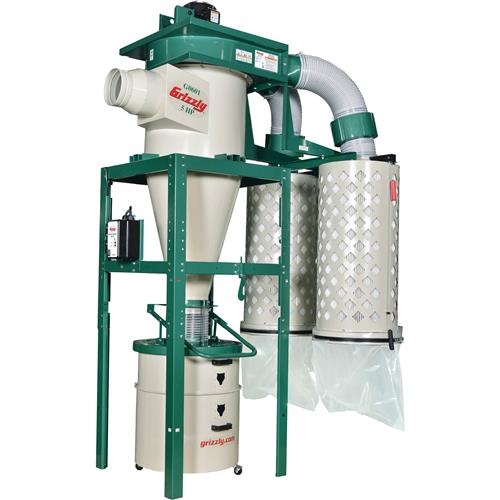

G0601 5 HP 3-Phase Cyclone Dust Collector
These cyclone dust collectors are the best in their class–at any price!
The cyclonic action created by the G0601 5 HP 3-Phase Cyclone Dust Collector separates the heavy dust particles from the fine particles and drops them into the 55-gallon steel drum.
Any remaining dust travels past the 16" diameter impeller and is then trapped by a cartridge filter made of spun-bond polyester that filters 99.9% of particles from 0.2 to 2 microns in size.
Each cartridge filter is pleated to provide 226 square feet of surface area for efficient air movement and a clear plastic bag collects the fine cake that shakes off the filter for consistent dust collector performance.
Casters mounted to the drum also make disposal of the larger chips and dust as easy as it gets.
Other features include: a vertical motor support for reduced vibration, thick walled 11-gauge steel blower housing, 14-gauge steel cyclone body, 360° blower rotation for easy connection to a duct system, TEFC Class "F" motor, and a filter cleaning device.
A rugged steel stand is included.
The upgraded T10881 HEPA Filter Kit is also available for those wanting to capture particles down to 0.3 microns.
The G0601 manual was written by our U.S.-based Technical Documentation Department and is packed with useful information. The complete and easy-to-read manual makes it easier to assemble and maintain your dust collector.
CSA certified
*This machine is prewired for 220V. We can rewire to 440V in a few days’ time for a fee. Please contact Grizzly Technical Support at (570) 546-9663 before placing your order.
