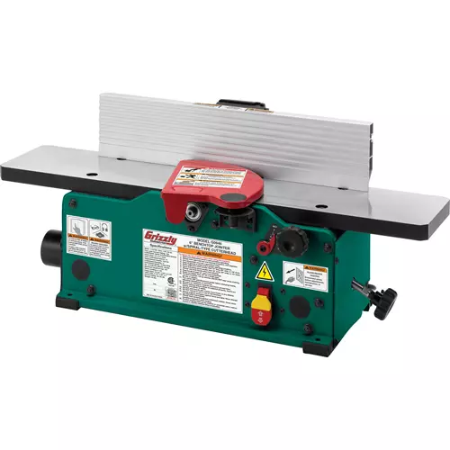

G0946 6" x 30" Benchtop Jointer with Spiral-Type Cutterhead
The best valued 6" benchtop jointer on the market.
This benchtop jointer features a spiral-type cutterhead for smoother finishes, quieter operation, and less maintenance compared with straight-knife cutterheads.
The 12 high-speed steel (HSS) inserts sit square to the axis of the cutterhead, with the cutting edges perpendicular to the workpiece. HSS has been heat treated for hardness and wear resistance, which keeps a sharp edge longer than other carbon steels.
Each two-sided insert can each be rotated once to expose a new sharp edge.
The T32739 replacement inserts are available and sold in packs of ten when the stock inserts get dull. All 12 will need to be replaced at the same time.
The overall size of the inserts contacting the lumber reduces noise due to a smaller pattern of air being pushed by the cutterhead. The sawdust created by this machine is then finer which is less likely to create clogged dust lines.
Compact in size, the G0946 has a small footprint making it easy to move from jobsites and stores easily when you want it out of the way. Benchtop models have a bad reputation for being underpowered. The 1-1/2 HP motor is bigger than “traditional” 1 HP motor options from other brands.
Budget-friendly and ready for the jobsite or garage.
  • Motor: 1-1/2 HP, 120V, single-phase, 10A
  • Maximum width of cut: 6"
  • Maximum depth of cut: 1/8"
  • Minimum workpiece length: 10"
  • Number of cuts per minute: 66,000
  • Cutterhead type: 6-Row spiral-type
  • Cutterhead diameter: 2"
  • Cutterhead speed: 11,000 RPM
  • Cutter insert type: Indexable HSS
  • Cutter insert size: 14mm x 14mm x 2mm
  • Number of inserts: 12
  • Table size: 6-1/4" x 30"
  • Fence size: 19-3/4" L x 4-1/4" H
  • Dust port size: 2-1/2" (compatible with standard shop vacuums)
  • Footprint: 19" x 9-1/2"
  • Overall dimensions: 30" W x 17-1/2" D x 13" H
  • Approximate shipping weight: 44 lbs.
  • Spiral-type cutterhead with twelve indexable HSS inserts
  • Cast aluminum infeed and outfeed tables
  • Infeed table height adjustment lock
  • Extruded aluminum fence
  • Built-in dust collection system with 2-1/2" dust port
