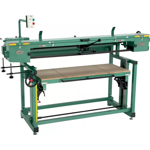

G0679 6" x 186" Combination Stroke/Edge Sander
Precise positioning for perfect finishing: A must-have for door and cabinet shops!
If you make doors, cabinet doors, or face frames, you’ll love the G0679 6" x 186" Stroke Sander. The worktable slides forward and backward, while the 6" x 10-1/2" movable, graphite-coated platen glides left and right, allowing you to apply just the right amount of pressure precisely where you need it.
Need to sand edges? This machine converts to a large-capacity edge sander in seconds, featuring a 69" long, graphite-coated platen. The G0679 also boasts ball-bearing table and platen guides, two 4" dust ports, a prominent magnetic switch that swivels for optimal positioning, adjustable work stops, and handwheel belt tensioning. For enhanced safety and quick set-up transitions, it even includes a motor brake!
The sanding belts are 6" wide by 186" long. For a full range of replacement belts for the G0679, shop here.
The G0679 is a real workhorse in any custom woodworking shop.
  • Motor: 3 HP, 220V, single-phase, 17A
  • Table size: 59" x 23-3/4"
  • Table vertical travel: 21-3/8"
  • Platen horizontal travel: 50-1/2"
  • Table lateral travel: 18"
  • Sanding belt size: 6" x 186"
  • Belt speed: 3600 SFPM
  • Drive wheel diameter: 8"
  • Overall size: 98" x 47-5/8" x 67-1/2"
  • Approximate shipping weight: 744 lbs.
  • Sanding belt tilts 90° for edge sanding
  • Fully adjustable belt tracking and tension
  • Table travels on ball-bearings
  • Table elevation is manually operated
  • Two 4" dust ports
  • Pedestal mounted magnetic switch
  • Motor brake
We offer U.S.-based customer service and technical support to get your questions answered and help keep your equipment running in top condition. And to ensure your satisfaction, the G0679 comes with a 1-year warranty.
The G0679 manual was written by our U.S.-based Technical Documentation Department and is packed with useful information. The complete and easy-to-read manual makes it easier to assemble and maintain your sander.
