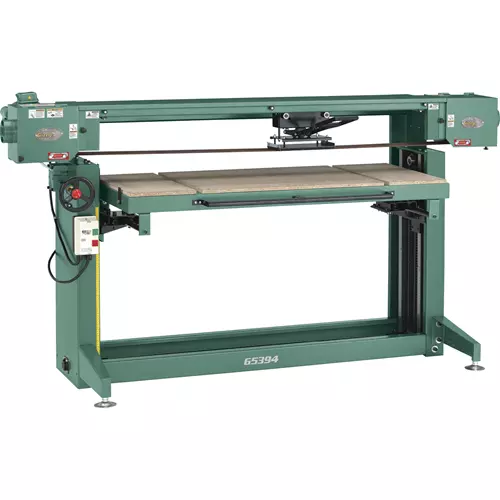

G5394 Stroke Sander
Effortless sanding for large workpieces.
Tackle demanding sanding jobs with the G5394 Stroke Sander. This powerhouse handles heavy stock removal and delivers a smooth, flawless finish, making it ideal for production shops.
Precision Control & High Capacity
- Variable Pressure Control: The manually-operated platen glides on ball bearings for precise application of pressure exactly where you need it.
- 24" Vertical & 18" Lateral Travel: The versatile table accommodates large panels and offers exceptional control for detailed work.
- Heavy-Duty Performance: The 3 HP motor and large 6" x 186" sanding belt power through tough sanding tasks.
Additional Features:
- Adjustable Belt Tracking & Tension: Ensures consistent sanding results and extends belt life.
- Dual Dust Ports: Minimize dust in your workspace for a cleaner sanding environment.
- Swiveling Platen Handle: Provides comfortable operation in various positions.
The sanding belts are 6" wide by 186" long. For a full range of replacement belts for the G5394, shop here.
The G5394 manual was written by our U.S.-based Technical Documentation Department and is packed with useful information. The complete-and-easy to read manual makes it easier to assemble and maintain your sander.
- Motor: 3 HP, 220V, single-phase, 17A
- Sanding belt speed: 3500 SFPM
- Sanding belt size: 6" x 186"
- Table Size: 58" x 23-3/4"
- Table vertical travel: 24"
- Platen horizontal travel: 59"
- Table lateral travel: 18"
- Drive roller diameter: 8"
- Footprint: 70" L x 30-1/2" W
- Overall dimensions: 93-3/4" W x 38" D x 50" H
- Approximate shipping weight: 690 lbs.
We offer U.S.-based customer service and technical support to get your questions answered and help keep your equipment running in top condition. And to ensure your satisfaction, the G5394 comes with a 1-year warranty.
