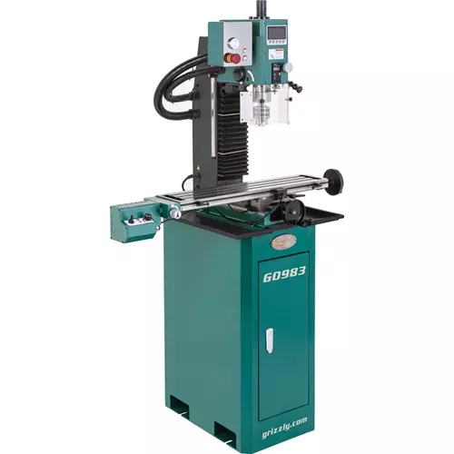

G0983 6" x 27" Variable-Speed Mill/Drill w/ Mirror Display,3-Axis DRO, Power Feed & Stand
A feature-packed milling machine with convenient digital readouts to enhance your production outcomes.
This efficient mill/drill is an ideal option for a small metalworking shop, and it includes all the options needed for milling, drilling, and tapping so you can complete every project easily.
The most unique feature of this exceptional machine is the exclusive display; it offers a mirror finish when off and easy-to-view backlit LED display when on. This machine will be a visual stand-out in your workshop!
The built-in 3-axis DRO and spindle speed and depth readout make it easy to check and adjust settings quickly as you work; the unit also includes a helpful temperature display.
The X-axis table power feed provides precision powered longitudinal table movement with adjustable limit stops for a preset range of motion.
The coarse and fine spindle downfeed options allow for versatility and ease in switching between feed types.
Stability and precision are guaranteed with the dovetail headstock column and table ways, providing rigidity for your milling and drilling processes.
With easy-to-use controls you can complete every function with minimal delays.
A front-mounted E-stop button increases safety by allowing you to immediately stop the machine when needed.
The G0983 manual was written by our U.S.-based Technical Documentation Department and is packed with useful information.
  • Motor: 1 HP, 110V, single-phase, 11A
  • Spindle taper: R-8
  • Maximum distance spindle to table: 12-3/8"
  • Maximum distance spindle to column: 6-1/2"
  • Spindle travel: 2-3/4"
  • Spindle speed: Variable, 100–2000 RPM
  • Vertical head travel: 9-1/4"
  • Table size: 6-3/8" x 27-1/2"
  • Table travel (longitudinal): 19-3/4"
  • Table travel (cross): 6-1/2"
  • T-slots: 3 @ 1-9/16" centers, 12mm wide
  • Drilling capacity cast-iron: 3/4"
  • Drilling capacity mild steel: 5/8"
  • End milling capacity: 5/8"
  • Face milling capacity: 2"
  • Footprint: 22" x 14-1/2"
  • Overall dimensions: 42-1/2" x 24-1/2" x 65-1/2"
  • Approximate shipping weight: 384 lbs.
  • Specialized mirror display – mirror finish when OFF and backlit LED view when ON
  • 3-Axis DRO and digital readouts for spindle depth and speed
  • Longitudinal power feed
  • Coarse and fine spindle downfeed
  • Dovetail headstock column and table ways
  • Temperature display
  • Front-mounted E-stop button
  • 1-year limited warranty
