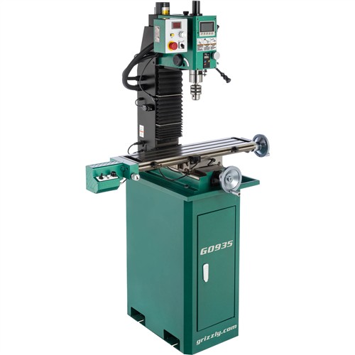

G0935 7" x 29" 1-1/2 HP Mill/Drill w/ Power Head Elevation & DRO
With all of its amazing features, this mill / drill is in a class of its own.
If you are looking for a highly sophisticated combination milling drilling machine with all the bells and whistles, look no further than the G0935 1-1/2 HP Mill/Drill.
This machining center incorporates high-level features such as a 3-axis digital DRO, Z-axis spindle DRO, a variable-speed X-axis power feed, and a powered head for quickly setting the desired Z-height.
Electronic variable speed (EVS) allows for on-the-fly speed adjustments–no need for belt changes.
This Mill/Drill is also equipped with a variable-speed 1-1/2 HP hi-torque motor with a digital RPM readout, an R-8 spindle, and a fine feed depth control.
The G0935 features a spindle-depth DRO for accurate and repeatable cuts.
The 7" x 29" milling table allows ample room for projects of all sizes, while a 1-1/8” drilling capacity provides stout cutting capability.
Like all Grizzly mills, the G0935 comes with a 1-year limited warranty.
The Grizzly Customer Service and Technical Support Teams are U.S.-based. Parts for the milling machines may be available online and shipped from the Grizzly parts warehouse in Springfield, MO.
  • Motor: 1-1/2 HP, 110V, single-phase, 12A
  • Spindle taper: R-8
  • Spindle Speed: Variable, 80-1700 RPM low, 280-5000 RPM high
  • Max. distance spindle to column: 9-1/16"
  • Max. distance spindle to table: 12-5/8"
  • Spindle travel: 3-5/64"
  • Drilling capacity: 1- 1/8"
  • Head travel: 13-3/8"
  • Table size: 29-1/8" x 7-1/16"
  • Longitudinal travel: 19-11/16"
  • Cross travel: 7-7/8"
  • T-slots: 3 @ 2-1/16 centers, 15/32" W
  • End milling capacity: 3/4"
  • Face milling capacity: 1-15/16"
  • Footprint: 20-1/2" x 11-1/2"
  • Overall dimensions: 37-1/2" W x 32" D x 36" H
  • Approximate shipping weight: 574 lbs.
  • 3-Axis DRO with quill DRO and 0.001" resolution
  • Variable-speed spindle with digital RPM display
  • Variable-speed X-axis power feed table
  • 3" Spindle stroke with fine downfeed
  • Forward/reverse spindle control
  • 1–16mm JT6 drill chuck
  • Cabinet stand with built-in storage
  • LED work light
