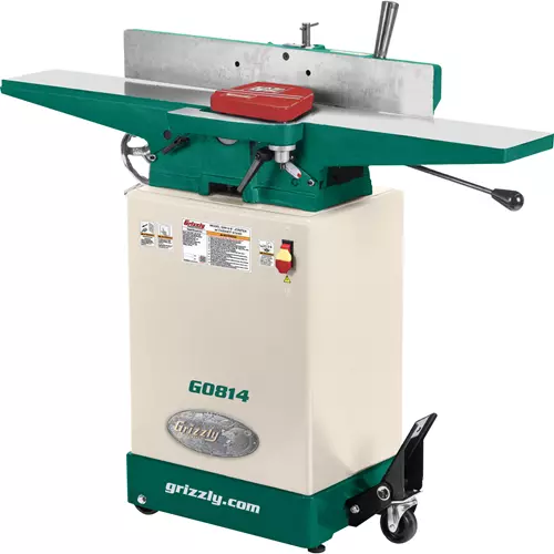

G0814 6" x 48" Jointer with Cabinet Stand
A dual-voltage 6” jointer with built-in mobile base — ideal for small shops.
This 6" jointer features precision-ground cast-iron tables on dovetail ways for smooth and accurate table adjustments.
The center-mounted fence is fully adjustable with convenient stops at 45°, 90° and 135° for the most common bevels.
The one-piece cabinet-stand gives a solid, clean appearance and provides stability.
The G6697 replacement blades are available when the stock blades get dull. An upgraded V-helical cutter head of the T31849 is also available for cleaner cuts with no tearout.
For increased mobility, the cabinet stand comes with a built-in mobile base.
Like all of the Grizzly jointers, the G0814 comes with a 1-year warranty covering parts and assuring the unit is free from factory defects. (Consumables are not covered by the warranty.)
The G0814 manual was written by our U.S. based Technical Documentation Department and is packed with useful information. The complete and easy-to-read manual makes it easier to assemble and maintain your jointer.
Parts and accessories for the jointer may be available online and shipped from the Grizzly parts warehouse in Springfield, MO.
