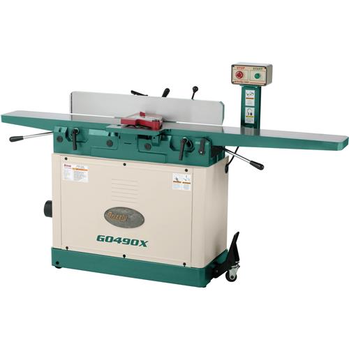

G0490X 8" x 76" Jointer with Parallelogram Beds and Spiral Cutterhead
The next level in 8" jointers.
Professionals and hobbyist woodworkers alike, you can't go wrong with the exceptional value of the G0490X 8" x 76" Jointer with parallelogram tables and 4-row spiral cutterhead.
With the spiral cutterhead, dealing with dull or nicked edges is as easy as loosening screws and turning any of the 40 carbide inserts to a fresh edge. This process will reduce tearout and save you time over sharpening and resetting straight knives like a traditional jointer cutterhead requires.
This parallelogram jointer features an infeed table over 43" that is helpful for surfacing longer stock. With the parallelogram table setup, the four points of contact allow for easy adjustment of each table for perfect alignment.
The easy-to-use lever-controlled table elevation quickly adjusts the table height. The 5" tall, center-mounted fence is amazing for edge-jointing wide stock. The built-in mobile base allows you to easily move this beast around the shop as needed.

  • Motor: 3 HP, 240V, single-phase, 15A
  • Maximum width of cut: 8"
  • Maximum depth of cut: 1/8"
  • Maximum rabbeting depth: 1/2"
  • Cutterhead diameter: 3-3/8"
  • Cutterhead type: 4-Row spiral
  • Insert size, type: 14 x 14 x 2mm, Indexable carbide
  • Cutterhead speed: 4800 RPM
  • Table size: 8" x 76-3/8"
  • Fence size: 36" L x 5" H
  • Minimum stock length: 10"
  • Dust port size: 4"
  • Footprint: 16-1/2" x 44-1/2"
  • Overall dimensions: 76-3/8" W x 24" D x 45-1/2" H
  • Approximate shipping weight: 566 lbs.
  • Precision-ground cast-iron tables
  • Parallelogram table adjustment
  • Rabbeting table
  • 5" Tall center-mounted fence with angle gauge
  • Fence stops at 45°, 90°, and 135°
  • Pedestal-mounted switch for easy access
