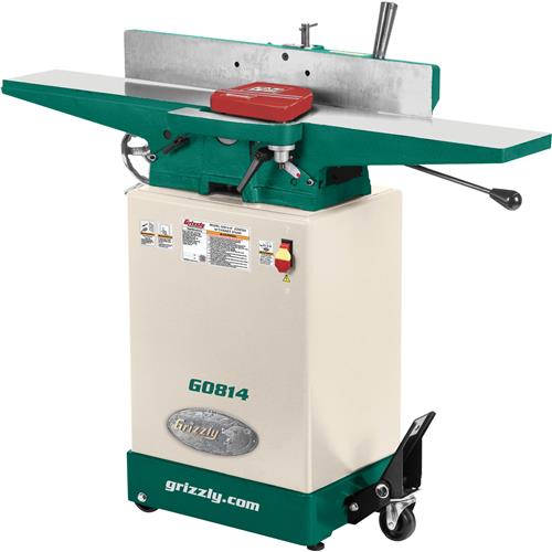

G0814 6" x 48" Jointer with Cabinet Stand
A dual-voltage 6” jointer with built-in mobile base — ideal for small shops.
This 6" jointer features precision-ground cast-iron tables on dovetail ways for smooth and accurate table adjustments.
The center-mounted fence is fully adjustable with convenient stops at 45°, 90° and 135° for the most common bevels.
The one-piece cabinet-stand gives a solid, clean appearance and provides stability.
The G6697 replacement blades are available when the stock blades get dull. An upgraded V-helical cutter head of the T31849 is also available for cleaner cuts with no tearout.
For increased mobility, the cabinet stand comes with a built-in mobile base.
