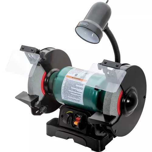

The T27305 8" Variable-Speed Grinder with Light sports a 3/4 HP, 120V motor with a range of 2000–3400 RPM to address all your grinding needs.
The adjustable gooseneck light and adjustable eye shields allows you to put the light right where you need it and make sure you're safe about it as well.
It also features aluminum tool rests and a coolant tray, as well as a two wheels (one 36-grit and one 60-grit) to get you started.

- Motor: 3/4 HP, 120V, Single-Phase, 5A
 - Right wheel grit: 36-Grit
 - Left wheel grit: 60-Grit
 - Wheel material: Aluminum oxide
 - Wheel speed: Variable, 2000-3400 RPM
 - Wheel bore: 5/8"
 - Wheel dimensions: 8" Diameter x 1" thick
 - Overall dimensions: 17" W x 13" D x 14-1/2" H
 - Approximate shipping weight: 44 lbs.
- Variable-speed control
 - Cast-iron base
 - Multi-angle positional light and eye shields
 - Left tool rest grooved for drill bits
