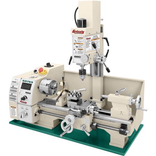

G0769 8" x 16" Variable-Speed Combination Lathe/Mill
The G0769 Lathe / Mill combination unit is an excellent choice for those who want to machine small parts without having to dedicate a large amount of shop space or dollars to get started.
The G0769 adds a variable-speed milling head to the lathe, giving you two versatile metal working machines in one.

LATHE SPECIFICATIONS:
- Swing over bed: 8-1/4"
- Swing over cross slide: 4-5/8"
- Swing over saddle: 6-7/8"
- Distance between centers: 15-3/4"
- Bed width: 4"
- Spindle bore: 0.787" (20mm)
- Spindle type: Intrinsic back plate
- Spindle taper: MT#3
- Tailstock taper: MT#2
- Tailstock quill travel: 2"
- Cross slide travel: 3"
- Compound travel: 2-1/8"
- Spindle speed: Variable, 50–2000 RPM
- Longitudinal feeds: (2) 0.0037, 0.0068 in./rev.
- Inch thread range: (15) 9–44 TPI
- Metric thread range: (12) 0.4–3.0mm
MILL SPECIFICATIONS:
- Swing: 13"
- Spindle taper: MT#2
- Spindle travel: 1-3/4"
- Distance from spindle to table: 9-7/8"
- Distance from spindle to bed: 11-1/2"
- Head vertical travel: 6-5/16"
- Head tilt: 45° left/right
- Table dimensions: 3-1/8" W x 7-1/4" L x 1-1/8" T
- T-slots: two at 1/4", 1-1/2" on center
- Drawbar: 3/8-16 TPI, 8-1/2" L
- Max. tool bit size: 1/2"
- Drilling capacity: 1/2" (steel)
MAIN SPECIFICATIONS:
- Motor: 3/4 HP, 110V, single-phase 10A
- Footprint: 10-1/2" x 31-1/2"
- Overall dimensions: 36" W x 20" D x 34" H
- Approx. shipping weight: 287 lbs.
STANDARD EQUIPMENT:
- 4" three-jaw chuck with two sets of jaws
- 4" four-jaw chuck with reversible jaws
- 6-3/4" faceplate
- 4-way turret tool post
- Follow rest
- Steady rest
- 1/2" B-16 drill chuck
- Tool box with service tools
- Bottle for oil
- Replacement fuse
- MT#2 and MT#3 dead centers
