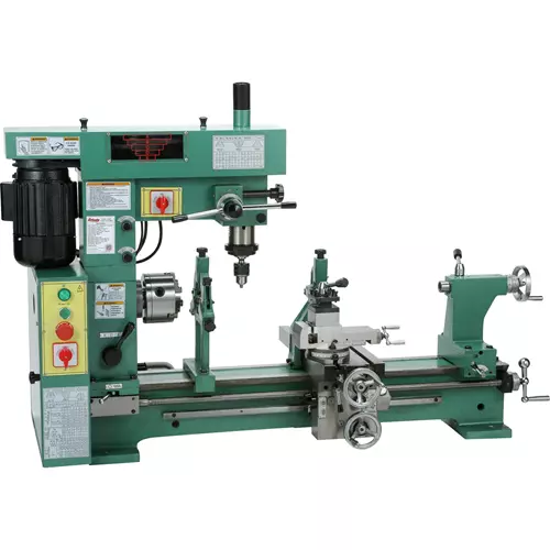

G9729 31" 3/4 HP Combo Lathe/Mill
Need a larger combo machine?
One with an awesome 31" between centers and 16-1/2" swing? The G9729 31" 3/4 HP Combo Lathe/Mill is the answer.
The lathe cuts inch and metric threads with ease and features a steady rest and a follow rest.
With great features like a magnetic controller and a forward/reverse switch, hardened and ground bedways, two motors for extra power, a built-in milling table with T-slots, and a 4-way turret tool post makes this a real do-it-all machine.
Convenient window allows easy verification of drill spindle speeds.
An incredible machine at an unbeatable price!
Like all lathe mills, the G9729 comes with a 1-year limited warranty.
The G9729 manual was written by our U.S.-based Technical Documentation Department and is packed with useful information. The complete and easy-to-read manual makes it easier to assemble and maintain your lathe mill.
The Grizzly Customer Service and Technical Support Teams are also U.S.-based. Parts for the machine may be available online and shipped from the Grizzly parts warehouse in Springfield, MO.
LATHE SPECIFICATIONS:
  • Motor: 3/4 HP, 110V, single-phase, 8.8A
  • Swing over bed: 16-1/2"
  • Swing over cross slide: 11-1/2"
  • Distance between centers: 31"
  • Spindle speeds: 7, 175–1425 RPM
  • Spindle bore: 1.107"
  • Spindle taper: MT #4
  • Tailstock barrel taper: MT #3
  • Tailstock travel: 2-1/2"
  • Cross slide travel: 7-1/2"
  • Compound travel: 3"
  • Longitudinal feeds: 24, 0.002–0.014 in/rev
  • Inch thread range: 44, 4–120 TPI
  • Metric thread range: 14, 0.75–6.0mm
MILL SPECIFICATIONS:
  • Swing: 22"
  • Distance from spindle to table: 12"
  • Distance from spindle to bed: 14-1/2"
  • Spindle speeds: 16, 120–3000 RPM
  • Spindle travel: 4-5/16"
  • Spindle taper: MT #3
  • Table dimensions: 6-1/4" W x 18-3/4" L x 1-1/4" H
  • T-slots: two at 7/16", 3.54" (90mm) on center
  • Maximum tool bit size: 1/2"
  • Drilling capacity: 1/2" (steel)
MAIN SPECIFICATIONS:
  • Footprint: 50" x 19"
  • Dimensions: 58" W x 40-1/2" D x 40" H
  • Approximate shipping weight: 692 lbs.
  • T-slots in cross slide
  • Carriage lock
  • Power cross feed
  • Power longitudinal feed
  • Fine downfeed
  • Hardened and ground bedways
  • Two separate motors
  • Built-in vise
  • Adjustable mill/drill head
STANDARD EQUIPMENT:
  • 1/2" Drill chuck with arbor
  • 2 Dead centers
  • 4-Way tool post
  • 5" 3-Jaw chuck
  • 9" Faceplate
  • Change gears
  • Follow rest
  • MT #3 chuck arbor 3/8" x 16 TPI
  • Steady rest
  • Threading dial
