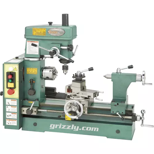

G4015Z 3/4 HP Combo Lathe/Mill
This lathe/mill combo is not your basic benchtop machine!
The G4015Z is a precision metalworking lathe/mill. The lathe features a 16-1/2" swing, 19-3/16" between centers, and 6 speeds ranging from 185 to 1455 RPM.
The lathe cuts inch and metric threads, features 9 longitudinal feeds, and comes with a 4" three-jaw scroll chuck and 9-1/2" faceplate.
The compound rest features a built-in vise and the cross slide conveniently doubles as a mill table.
Meanwhile, the milling portion of the machine features a swing of 12", 14 speeds ranging from 117 to 1300 RPM, and a vise with a 2-3/4" capacity.
It sports an adjustable head, coarse and fine downfeed controls, and comes with a 1/2" drill chuck with arbor.
With the G4015Z, you get a lot of machine in a small package with all the features you need for just about any job!
Like all Grizzly machines, the G4015Z comes with a 1-year limited warranty.
The G4015Z manual was written by our U.S. based Documentation Department and is packed with useful information. The complete and easy-to-read manual makes it easier to assemble and maintain your combination lathe mill.
The Grizzly Technical Support team is also U.S.-based. Parts for the machine may be available online and shipped from the Grizzly parts warehouse in Springfield, MO.
LATHE SPECIFICATIONS:
  • Swing over bed: 16-1/2"
  • Swing over saddle: 11-1/2"
  • Distance between centers: 19-3/16"
  • Bed width: 5-1/2"
  • Spindle speeds: 7, 185–1455 RPM
  • Spindle bore: 0.787"; 20mm
  • Spindle taper: MT#3
  • Tailstock taper: MT#3
  • Tailstock quill travel: 1-1/2"
  • Cross slide travel: 4-1/2"
  • Compound travel: 3"
  • Maximum tool bit size: 1/2"
  • Leadscrew: 7/8"x 6 TPI
  • Longitudinal feeds: 8, 0.0020–0.0069 in/rev
  • Inch thread range: 27, 8–120 TPI
  • Metric thread range: 18, 0.2–3.0mm
MILL SPECIFICATIONS:
  • Swing: 12"
  • Distance from spindle to table: 10"
  • Distance from spindle to bed: 15-3/4"
  • Spindle speeds: 14, 117–1300 RPM
  • Spindle travel: 3-1/2"
  • Head vertical travel: 3"
  • Table dimensions: 6" W x 7-1/4" L x 1-1/2" H
  • T-slots: two at 7/16", 3.54" (90mm) on center
  • Drilling capacity: 1/2" (steel)
MAIN SPECIFICATIONS:
  • Motor: 3/4 HP, 110V, single-phase 8.7A
  • Dimensions: 42" W x 23" D x 35" H
  • Approximate shipping weight: 475 lbs.
  • Cross slide doubles as a mill table
  • Coarse and fine mill spindle downfeed
  • Adjustable milling head
  • Built-in vise on compound rest
  • Cuts inch and metric threads
INCLUDES:
  • 1/2" Drill chuck with arbor
  • Two dead centers
  • 4" Three-jaw scroll chuck
  • 4-Way tool post
  • 9-1/2" Faceplate
  • 5" Backplate
  • MT#3 chuck arbor
