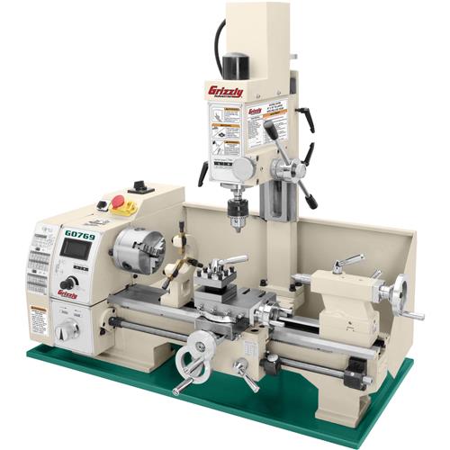

G0769 8" x 16" Variable-Speed Combination Lathe/Mill
The G0769 Lathe / Mill combination unit is an excellent choice for those who want to machine small parts without having to dedicate a large amount of shop space or dollars to get started.
The G0769 adds a variable-speed milling head to the lathe, giving you two versatile metal working machines in one.
Mount it directly to your sturdy workbench or put it on the T26599 Optional Stand and store all of your tooling and accessories directly within reach.
Like all Grizzly lathes, the G0769 comes with a 1-year warranty covering parts and assuring the unit is free from factory defects.
The G0769 manual was written by our U.S. based Documentation Department and is packed with useful information. The complete and easy-to-read manual makes it easier to assemble and maintain your lathe.
The Grizzly Technical Support team is U.S. based. Parts and accessories for the lathe may be available online and shipped from the Grizzly parts warehouse in Springfield, MO.
LATHE SPECIFICATIONS:
  • Swing over bed: 8-1/4"
  • Swing over cross slide: 4-5/8"
  • Swing over saddle: 6-7/8"
  • Distance between centers: 15-3/4"
  • Bed width: 4"
  • Spindle bore: 0.787" (20mm)
  • Spindle type: Intrinsic back plate
  • Spindle taper: MT#3
  • Tailstock taper: MT#2
  • Tailstock quill travel: 2"
  • Cross slide travel: 3"
  • Compound travel: 2-1/8"
  • Spindle speed: Variable, 50–2000 RPM
  • Longitudinal feeds: (2) 0.0037, 0.0068 in./rev.
  • Inch thread range: (15) 9–44 TPI
  • Metric thread range: (12) 0.4–3.0mm
MILL SPECIFICATIONS:
  • Swing: 13"
  • Spindle taper: MT#2
  • Spindle travel: 1-3/4"
  • Distance from spindle to table: 9-7/8"
  • Distance from spindle to bed: 11-1/2"
  • Head vertical travel: 6-5/16"
  • Head tilt: 45° left/right
  • Table dimensions: 3-1/8" W x 7-1/4" L x 1-1/8" T
  • T-slots: two at 1/4", 1-1/2" on center
  • Drawbar: 3/8-16 TPI, 8-1/2" L
  • Max. tool bit size: 1/2"
  • Drilling capacity: 1/2" (steel)
MAIN SPECIFICATIONS:
  • Motor: 3/4 HP, 110V, single-phase 10A
  • Footprint: 10-1/2" x 31-1/2"
  • Overall dimensions: 36" W x 20" D x 34" H
  • Approx. shipping weight: 287 lbs.
STANDARD EQUIPMENT:
  • 4" three-jaw chuck with two sets of jaws
  • 4" four-jaw chuck with reversible jaws
  • 6-3/4" faceplate
  • 4-way turret tool post
  • Follow rest
  • Steady rest
  • 1/2" B-16 drill chuck
  • Tool box with service tools
  • Bottle for oil
  • Replacement fuse
  • MT#2 and MT#3 dead centers
