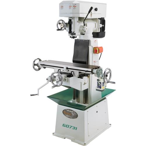

G0731 8" x 30" 1-1/2 HP Vertical Mill with Power Feed
The G0731 8" x 30" 1-1/2 HP Vertical Mill is equipped with a longitudinal power feed and limit switch for controlled X-axis table movement.
It accommodates up to a 14" swing and 20" between table and spindle.
The G0731 features nine spindle speeds from 300 to 2840 RPM for milling solid materials.
The head tilts 45° left-to-right and the turret rotates 360°, enabling extremely versatile operations.
To reduce the time spent doing daily lubrication, this milling machine is outfitted with an one-shot lubrication system that is as quick and easy as one pump of a lever.
Prewired for 110V, the G0731 can plug into a standard 110V wall receptacle or can be converted to operate on a 220V power supply. If you prefer 220V, refer to the Voltage Conversion instructions in the manual.
Features a cabinet designed to accept aftermarket coolant systems, making it readily upgradable.
