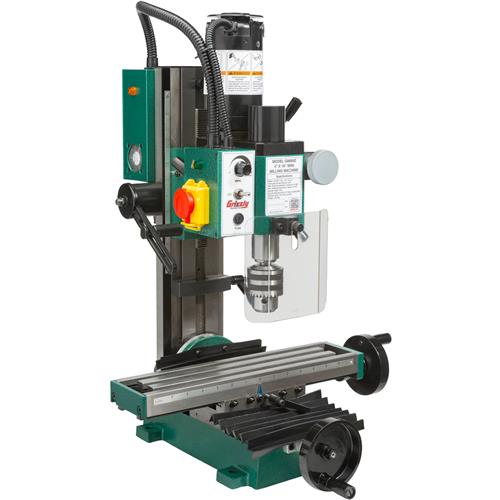

G8689Z 4" x 16" Mini Milling Machine
An ideal benchtop milling machine for the home hobbyist.
The G8689Z 4" x 16" Mini Milling Machine can power through up to 1/2" drilling, 1/2" end mills, and 1" facing for the consistent results you need.
This benchtop mill features the highly stable R8 spindle that offers versatility, quick and easy tool changes, and exceptional accuracy.
The variable-speed control and gear drive save you time and hassle as you switch between projects. The G8689Z has two speed ranges: low range 0–1100 RPM, and high range 0–2500 RPM.
Modify the spindle height with the rapid downfeed, or use the micro downfeed to adjust down to 0.001" (one full revolution is 0.060").
The headstock adjusts up and down the column and tilts 45° left or right relative to the table, and adaptable dovetail ways offer precision and rigidity.
You can set the limit block to restrict the amount of head travel for repeated drilling of the same depth.
This mini milling machine also includes a clear chip guard on the spindle and a rubber chip guard on the ways for safety.
Like all Grizzly mills, the G8689Z comes with a 1-year limited warranty.
The G8689Z manual was written by our U.S.-based Technical Documentation Department and is packed with useful information.
The Grizzly Customer Service and Technical Support Teams are U.S.-based. Parts for the mill may be available online and shipped from the Grizzly parts warehouse in Springfield, MO.
  • Motor: 1/2 HP, 110V, single-phase, 4.5A
  • Spindle taper: R-8
  • Spindle speeds: Variable, 0-1100 and 0–2500 RPM
  • Maximum distance spindle to table: 10-1/2"
  • Maximum distance spindle-to-column: 6-3/8"
  • Table size: 15-3/4" x 3-5/8"
  • T-slots: 3 @ 1-1/8" centers, 1/2" wide
  • Table travel (longitudinal): 9-1/8"
  • Table travel (cross): 4"
  • Head travel: 9-1/2"
  • Column tilt: 45° L/R
  • Drilling capacity: 1/2" mild steel
  • End milling capacity: 1/2"
  • Face milling capacity: 1"
  • Overall size: 20" W x 20" D x 30" H
  • Approximate shipping weight: 135 lbs.
  • 1/2" drilling capacity in steel and cast iron
  • Adaptable R8 spindle
  • Two variable-speed spindle ranges on a geared drive
  • Fine feed head control
  • Zero-setting dials on handwheels w/0.001" graduations
  • Adjustable dovetail ways on column
  • Adjustable depth stop
  • Clear chip guard on spindle
  • Rubber chip guards on ways
INCLUDES:
  • 1/32"–1/2" JT33 drill chuck
  • R-8 x JT33 arbor
  • Two 3/8"-16 T-slot nuts
  • 3, 4, 5, 6mm hex wrenches
  • 8 x 10, 14 x 17, 17 x 19, 36mm open-end wrenches
  • 45–52mm spanner wrench
  • Oil bottle
