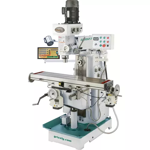

G0827 11" x 50" 2 HP Horizontal/Vertical Mill with DRO
Looking for unwavering torque and consistency in a solid gearhead mill?
This is it as it combines all the range of speeds you need with the size and features that any metalworking shop would want.
A milling machine with horizontal and vertical spindles performs a wide range of machining tasks without the need for extensive setup changes.
It features 8 vertical spindle speeds from 140–2100 RPM and 12 horizontal spindle speeds from 48–1560 RPM.
The head is mounted on a wide-dovetail movable ram with 18" of travel and can tilt 45° left to right. The turret has 180° rotating capability. The turret has 180° of swivel.
A Fagor 3-axis digital readout (DRO) reads down to a 0.0002" resolution for repeatable, accurate milling operations.
The G0827 features 3-axis table movement with independent longitudinal and horizontal power feeds. With the 11" x 50" table, you can set up a rotary table or another fixture on one side without having to remove your vise on the other!
And finally, this milling machine comes with a circulating coolant system with the pump and reservoir in the column base.
  • Required power source: 220V, 3-phase, min. 15A
  • Vertical spindle motor: 2 HP, 220V, 3-phase
  • Horizontal spindle motor: 3 HP, 220V, 3-phase
  • Coolant pump motor: 40W, 220V, 3-phase
  • Spindle taper: R-8
  • Vertical spindle speeds: 8, 140–2100 RPM
  • Horizontal spindle speeds: 12, 48–1560 RPM
  • Spindle travel: 5"
  • Max. distance spindle-to-column: 27-1/2"
  • Max. distance spindle-to-table: 17-1/16"
  • Table size: 11" x 50"
  • Longitudinal travel: 29"
  • Cross travel: 10-1/2"
  • Vertical travel: 13-9/16"
  • Ram Travel: 18"
  • Head turret/column swivel: 180°
  • Head tilt: 45°
  • Overall dimensions: 65" W x 67" D x 85" H
  • Approximate shipping weight: 2866 lb.
  • 3-Axis DRO
  • Horizontal and vertical R-8 spindles
  • High-precision P5 spindle bearings
  • Independent X- and Y-axis power feed
  • Coolant recycling system
  • LED work light
