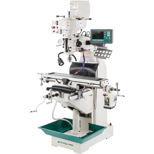

G0961 8" x 36" Variable-Speed Knee Mill with Power Feed and DRO
An affordable variable-speed knee mill for the home shop.
The G0961 8" x 36" Variable-Speed Knee Mill is a full-featured mill built for those operating with 110V power.
The R-8 spindle has 4-1/16" of travel and operates its variable-speeds between 100 and 2800 RPM.
The 8" x 36" precision-ground, cast-iron table has an X-axis power feed and is Y-axis power feed ready.
This machine has an X- and Y-axis DRO to ensure exact table and spindle positioning.
Additionally, this machine features a built-in 20-liter coolant system, a flexible coolant nozzle, LED work light, and a tool caddy.
The most feature-packed mill at this pricepoint.
Like all Grizzly knee mills, the G0961 comes with a 1-year warranty which covers parts and assures the unit is free from factory defects. (Consumables are not covered by the warranty.)
The G0961 manual was written by our U.S. based Technical Documentation Department and is packed with useful information. The complete and easy-to-read manual makes it easier to assemble and maintain your mill.
The Grizzly Customer Service and Technical Support Teams are U.S. based. Parts for the mill may be available online and shipped from the Grizzly parts warehouse in Springfield, MO.
  • Motor: 1-1/2HP, 110V, single-phase, 15A
  • Spindle taper: R-8
  • Spindle speeds: Variable, 100–2800RPM
  • Spindle travel: 4-1/16"
  • Ram travel: 10-1/2"
  • Head tilt: 90° L/R
  • Turret/column swivel: 180 degrees left/right
  • Table travel (longitudinal): 23"
  • Table travel (cross): 9-1/2"
  • Table travel (vertical): 13-3/4"
  • Table size: 8" x 36"
  • T-slots: 3, 5/8" wide
  • Footprint: 19-1/2" x 33"
  • Overall dimensions: 56" W x 56" D x 76-1/2" H
  • Approximate shipping weight: 1940 lbs.
  • X-axis power feed, Y-axis power feed ready
  • X and Y-Axis DRO
  • Digital RPM readout
  • R-8 Spindle
  • 20-Liter coolant system with catch tray
  • One-shot pump way lubrication system
  • Dual belt drive
  • LED work light and flexible blower
  • Spindle brake
  • Tool caddy
