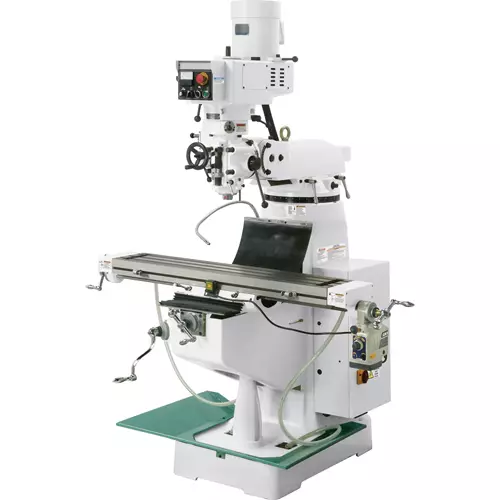

G0667X 9" x 48" 3 HP High Precision Variable-Speed Vertical Mill
A high performance and precision-controlled Grizzly mill.
The G0667X 9" x 48" 3 HP High Precision Variable-Speed Vertical Mill is used to remove material from metal workpieces to form complex shapes.
Attention to detail is evident by the use of high-class spindle bearings, hardened and ground leadscrews with double-bronze nuts, and a chromed quill with precision-honed housing,
Now add an electronic variable-speed spindle motor and you’ve got yourself one serious milling machine.
The bed of the lathe is constructed with Meehanite® castings that are hardened and precision-ground in the traditional three V-way prismatic design.
There are coarse and fine manual controls for quill movement, and an auto-downfeed mechanism with adjustable speeds.
A power feed provides precision powered longitudinal table movement with adjustable limit stops for preset range of motion.
The coolant reservoir in the base of the column houses a pump that recycles the fluid back up to the workpiece, reducing friction and washing away the resulting swarf from the operation.
  • Required power source: 220V, single-phase, 15A
  • Motor: 3 HP, 220V
  • Spindle travel: 5"
  • Spindle taper: R-8
  • Spindle speeds: Variable, 60–5000 RPM
  • Quill diameter: 3.375"
  • Quill feed rate: 0.0015", 0.003", 0.006"
  • Spindle nose to table: 0"–18"
  • Longitudinal travel: 29"
  • Cross travel: 12"
  • Vertical (Knee) travel: 16"
  • Table size: 9" x 48"
  • T-slots: 3 on 2-1/2" centers, 5/8" wide
  • Ram travel: 13"
  • Ram swivel: 360°
  • Head swivel: 90° left/right, 45° front/back
  • Overall dimensions: 57" W x 71" D x 87-1/2" H
  • Approximate shipping weight: 2352 lbs.
  • Power downfeed
  • Downfeed auto stop with micro-adjustable stop
  • Longitudinal power feed with 550 in/lbs. of torque
  • High-precision spindle with P4 class angular contact ball bearings
  • Built-in coolant tank in base casting
  • Heavy-duty spindle brake
  • Double-bronze nut on X- and Y-axis leadscrews
  • Chromed quill and honed housing
  • Meehanite® castings
  • One-shot pump table lubrication
