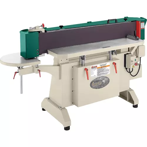

Grizzly G9984 - 9" x 138-1/2" Industrial Oscillating Edge Sander
4.9 (10)
$4,700.00
G9984 9" x 138-1/2" Industrial Oscillating Edge Sander
Built for those that demand the biggest and the best tools for their shop.
The G9984 9" x 138-1/2" Industrial Oscillating Edge Sander is the ideal solution for tackling your toughest edging jobs. This heavy-duty machine boasts a massive sanding head and extensive table travel to accommodate large workpieces.
The spacious 11-3/4" x 47-3/4" table tilts 0-45 degrees for sanding at various angles. An additional end table provides further support for long pieces. Both tables offer 8" of travel for exceptional control.
The 1/4" belt oscillation minimizes sanding marks and extends belt life for smoother finishing.
Belt tracking is as easy as turning the belt tracking adjustment knob. For a full range of replacement belts for the G9984, shop here.
With heavy-duty construction, the G9984 features a cast-iron base and a graphite-coated platen for long-lasting durability.
The G9984 manual was written by our U.S.-based Technical Documentation Department and is packed with useful information. The complete and easy-to-read manual makes it easier to assemble and maintain your edge sander.
  • Motor: 3 HP, 220V, single-phase, 15A
  • Sanding belt size: 9" x 138-1/2"
  • Sanding belt speed: 4120 FPM
  • Oscillations: 1/4"
  • Platen: Graphite-coated, 47-1/2" x 9-1/2"
  • Main table size: 11-3/4" x 47-3/4"
  • Main table vertical travel: 8"
  • Main table tilt: 0–45°
  • End table size: 18" x 13"
  • End table travel: 8"
  • Number of dust ports: 2
  • Dust port size: 4"
  • Footprint: 42" x 24-1/2"
  • Overall dimensions: 82" W x 24" D x 45-1/2" H
  • Approximate shipping weight: 873 lbs.
  • Sanding belt oscillates 1/4"
  • Quick-release belt lever
  • Fully-adjustable belt tracking and tension
  • Magnetic switch
  • 8" vertical table height adjustment
  • Table tilts 45°
We offer U.S.-based customer service and technical support to get your questions answered and help keep your equipment running in top condition. And to ensure your satisfaction, the G9984 comes with a 1-year warranty.
