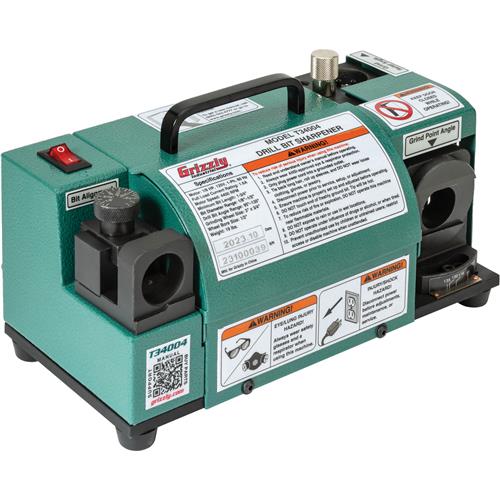

Grizzly T34004 Drill Bit Sharpener
Achieve the perfect edge on your drill bits with efficient sharpening.
This sharpener streamlines the process of honing your dull drill bits, delivering a smooth and low-vibration grind for exceptional results.
Equipped with a 230-grit cubic boron nitride wheel, it effortlessly sharpens both standard and split point bits, making the task a breeze. It's designed for drill bit diameters ranging from 1/8" to 1/2".
Using it is a breeze as well – just secure your bit in one of the 11 included ER-20 collets, insert the collet into the holder, power up the machine, and start grinding.
Compatible with various drill bit types, including HSS, M2 HSS, HSS titanium-coated, and M35 HSS cobalt, this machine restores an edge to all varieties.
Invest in this affordable solution to keep your bits in optimal condition, allowing you to sharpen them as needed and avoid unnecessary replacement costs.

  • Motor: 1/8 HP, 120V, single phase, 1.6A
  • Drill bit diameter range: 1/8"–1/2"
  • Drill bit minimum length: 1-3/4"
  • Drill bit angle range: 95°–135°
  • Drill bit point styles: Standard, split
  • Collet type: ER-20
  • Collets: 11, 1/8"–1/2"
  • Grinding wheel bore: 1/2"
  • Grinding wheel maximum diameter: 3"
  • Grinding wheel maximum width: 3/4"
  • Grinding wheel grit: 230
  • Footprint: 11" x 5"
  • Overall dimensions: 11" W x 6" D x 6-1/2" H
  • Approximate shipping weight: 20 lbs.
  • 230-Grit cubic boron nitride grinding wheel
  • Includes 11 ER-20 collets
  • Grinds standard and split point bits
  • Storage compartment for collets
  • Cast-iron body construction
  • 1-year limited warranty
COLLET SIZES:
  • 1/8", 5/32", 3/16", 7/32", 1/4", 5/16", 11/32", 3/8", 13/32", 7/16", 1/2"
