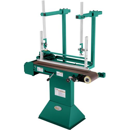

G0574 Guitar Fretboard Radiusing Sander
Speed up your production with this easy-to-use specialty sander.
Almost all guitar fretboards have a radius on them. For example, steel-string guitars generally have a 12", 14" or 16" radius across the fretboard. Electric guitars range from 10" to a compound radius that starts with a 10" at the nut and ends with a 14" radius at the pickup end.
Designed in the USA by our friends at Merlin 5, this exceptionally accurate sander is the ideal tool for shaping fretboards. It is the first commercially available, heavy-duty radiusing sander that is capable of sanding compound radii from 10" to 16," and everything in between!
With nearly 30" of sanding surface and a micro-adjustment knob for sanding height, you can effortlessly complete every sanding project. Additionally, the 28-1/2" x 1-1/2" aluminum base plate has plenty of room to mount a vacuum or clamping system for greater efficiency.
The sanding belts are 6" wide by 80" long. A full range of replacement belts are available.
If you shape your own guitar necks or fretboards, the G0574 Radius Sander machine will ensure precision results.
The G0574 manual was written by our U.S.-based Technical Documentation Department and is packed with useful information. The complete and easy-to-read manual makes it easier to assemble and maintain your sander.
  • Motor: 1.5 HP, 110V/220V (prewired 220V), single-phase, 20A/10A
  • Belt speed: 1800 FPM
  • Belt size: 6" x 80"
  • Platen type: Graphite-coated
  • Platen size: 6-3/4" x 29-3/4"
  • Dust port size: 4"
  • Overall dimensions: 42-1/2" W x 32" D x 74" H
  • Approximate shipping weight: 252 lbs.
  • Graphite-coated platen
  • Quick belt release
  • Micro adjustment knob for sanding height
  • 10" to 16" adjustable fretboard radius
  • Mechanical ON/OFF switch
  • Shielded and lubricated bearings
  • 4" dust port
  • Powder-coated finish
We offer U.S.-based customer service and technical support to get your questions answered and help keep your equipment running in top condition. And to ensure your satisfaction, the G0574 comes with a 1-year warranty.
