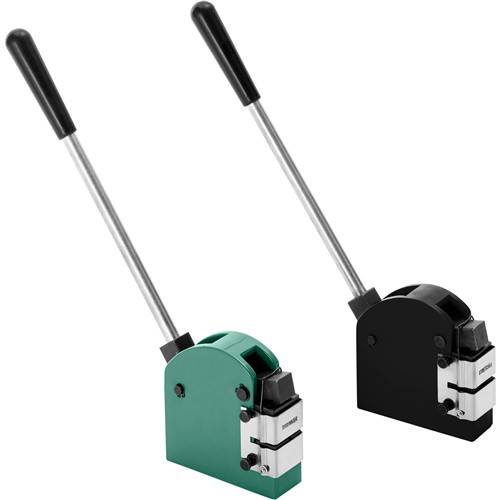

Switch between metal shrinking and metal stretching operations without changing your tooling!
Commonly used in autobody work, metal shrinker/stretchers make curves in sheet metal by compressing, or "shrinking," it and expanding, or "stretching," it.
It can create long, compound-curved metal pieces out of a single strip of metal without multiple splice points.
With one dedicated shrinker and one dedicated stretcher, you can clamp both tools in a vise and switch between operations without having to change out your dies.
To take full advantage of the set and to get 360° access to your workpiece, you can mount these tools to a stand intended for a bench grinder. To prevent tipping, be sure to fasten the grinder stand to the floor.
All this for less than the cost of two separate tools!
Like all Grizzly metalworking tools, the T31648 comes with a 1-year warranty which covers parts and assures the set is free from factory defects.
The T31648 instruction sheet was written by our U.S. based Technical Documentation Department and is packed with useful information.
The complete and easy-to-read document makes it easier to assemble and maintain your shrinker and stretcher.
Parts for the tools may be available online and shipped from the Grizzly parts warehouse in Springfield, MO.
  • Maximum thickness, aluminum: 16-gauge
  • Maximum thickness, mild steel: 18-gauge
  • Maximum thickness, stainless steel: 20-gauge
  • Smallest radius bend: 3"
  • Jaw depth 1"
  • Bolt pattern 2-1/2" on center
