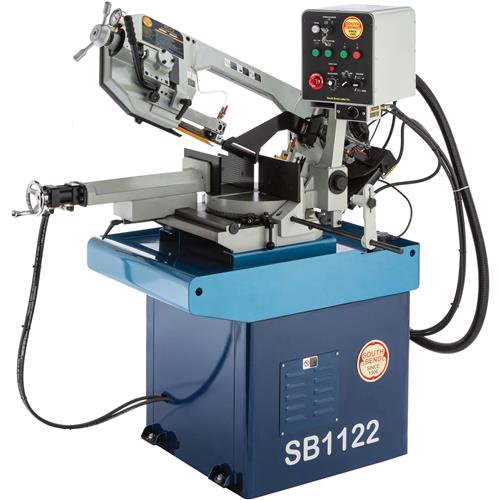

SB1122 9" x 12" 2 HP Metal-Cutting Bandsaw
A deluxe metal-cutting bandsaw built to perform.
The SB1122 9" x 12" 2 HP Metal-Cutting Bandsaw has the high-end features and precision components designed to meet your business's exacting standards.
You'll get absolute control with variable blade speed and hydraulically powered head with variable-speed downfeed and vise—both featuring an auto-retract function.
The swiveling head lets you cut angles from -45° to +60° with an adjustable work stop for repeat cuts in a production environment.
A built-in blade coolant system with blade brush improves cut accuracy and prolongs blade life.
With the hydraulic power and variable speed at your fingertips, plus the option for auto or manual controls, this versatile saw can help you boost production and quality like no other.
