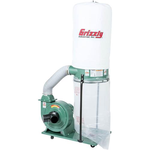

G1028Z2 1-1/2 HP Portable Dust Collector
One of the most affordable 1-1/2 HP portable dust collectors on the market.
The G1028Z2 1-1/2 HP Portable Dust Collector is designed to capture dust and wood chips from woodworking machines, such as table saws, jointers, and planers.
The air drawn in by the dust collector is filtered before it returns to the workspace.
The G1028Z2 has an air suction capacity of 1300 CFM and has a max static pressure of 9.0 in.
Static pressure is produced by the 12-3/4" cast-aluminum impeller to move the wood chips into the collector.
The G1028Z2 features a 2.5-micron upper filter top bag to capture the fine dust particles that normally end up all over your shop.
The steel base has been fitted with casters for mobility in your garage or shop.

- Motor: 1-1/2 HP, 120V/240V (prewired for 120V), single-phase, 12A/6A
- Air suction capacity: 1300 CFM
- Static pressure: 9"
- Impeller: 12-3/4" cast aluminum
- Collection capacity: 42.6 gallons (5.7 cu. ft.)
- Upper bag filtration: 2.5 micron
- Bag size (dia. x depth): 19-1/2" x 33" (2)
- Powder coated paint
- Overall dimensions: 33-1/2" W x 21-1/2 L x 78" H
- Approximate shipping weight: 118 lbs.
- 2.5 Micron upper bag filtration
- 12-3/4" Cast-aluminum impeller
- Steel base with casters for mobility
- 6" inlet "Y" with two 4" openings
