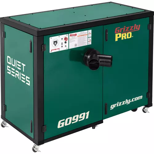

G0991 1-1/2 HP Quiet Series® Horizontal Cyclone Dust Collector
Space-saving Grizzly PRO horizontal dust collector with 1-micron filtration and user-friendly mobility.
Eliminate dust and debris from your workshop with this totally enclosed horizontal dust collector from the Grizzly PRO line! A compact, mobile design offers unmatched adaptability that sets the G0991 apart from conventional dust collectors. And to boost shop efficiency, you can add a workbench on top to create a practical mobile workstation.
Experience the benefits of 1-micron cartridge filtration and powerful cyclonic action to minimize wood particles and dust in your shop. This dust collector can be hooked up to two machines running simultaneously; it makes a great point-of-use dust collector or set it up for permanent installations.
Improve your shop air with this heavy-duty horizontal dust collector that only gives off 71dB of noise. And with a full-featured control panel with remote, easy chip disposal, and dual voltage 110V/220V operation, you can operate this dust collector continuously and keep your woodworking machines running at full capacity.
FEATURES & BENEFITS:
  • Space-Saving: Horizontal design allows for multiple configurations based on your unique requirements, including use underneath machines.
  • Convenient Mobility: Offers four lockable casters for effortless movement around your shop or storage when not in use.
  • 1-Micron Filtration: A MERV-16 pleated cartridge filter effectively captures minute dust.
  • Cyclone Separator: Cyclonic air movement forces heavier material into the collection drum while the filter captures fine particles.
  • Quiet Operation: Part of the Quiet Series® lineup with a low 71dB sound rating.
  • Full-Featured Control Panel: Includes a full-drum alarm, remote on/off switch, and lighted power-on indicator.
  • Collection Drum: An easy-to-remove 20-gallon collection drum makes chip and debris disposal simple and ensures effortless maintenance.
  • Dual-Voltage Single-Phase Operation: The cyclone dust collector works with standard single-phase power with options for 110V or 220V.
  • SPECIFICATIONS:
  • Motor: 1-1/2 HP, 110V/220V (prewired 110V), single-phase, 15A/7.5A
  • Main inlet size: 6"
  • Adapter inlet size: 4" (2)
  • Impeller: 12-1/2", radial fin
  • Airflow capacity: 735 CFM @ 1.3 in. SP
  • Max. static pressure: 10"
  • Filtration: 99.97% @ 1-Micron
  • Filter type: MERV-16 pleated cartridge
  • Filter surface area: 20 Sq. ft.
  • Collection drum size: 20 Gallons
  • Sound rating: 71 dB
  • Footprint: 53" x 26"
  • Overall size: 53" W x 27-1/2" D x 40-1/2" H
  • Approx. shipping weight: 510 lbs.
  • Improve your shop's air quality and maximize your workspace with the versatile G0991 Horizontal Cyclone Dust Collector.
    Grizzly owner's manuals and instruction sheets are produced by our U.S.-based Technical Documentation Department and are packed with useful information. Parts may be available online and are shipped from the Grizzly parts warehouse in Springfield, MO.
