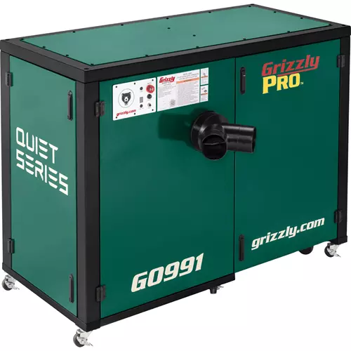

G0991 1-1/2 HP Quiet Series® Horizontal Cyclone Dust Collector
Space-saving Grizzly PRO horizontal dust collector with 1-micron filtration and user-friendly mobility.
Eliminate dust and debris from your workshop with this totally enclosed horizontal dust collector from the Grizzly PRO line! A compact, mobile design offers unmatched adaptability that sets the G0991 apart from conventional dust collectors. And to boost shop efficiency, you can add a workbench on top to create a practical mobile workstation.
Experience the benefits of 1-micron cartridge filtration and powerful cyclonic action to minimize wood particles and dust in your shop. This dust collector can be hooked up to two machines running simultaneously; it makes a great point-of-use dust collector or set it up for permanent installations.
Improve your shop air with this heavy-duty horizontal dust collector that only gives off 71dB of noise. And with a full-featured control panel with remote, easy chip disposal, and dual voltage 110V/220V operation, you can operate this dust collector continuously and keep your woodworking machines running at full capacity.
FEATURES & BENEFITS:
  • Space-Saving: Horizontal design allows for multiple configurations based on your unique requirements, including use underneath machines.
  • Convenient Mobility: Offers four lockable casters for effortless movement around your shop or storage when not in use.
  • 1-Micron Filtration: A MERV-16 pleated cartridge filter effectively captures minute dust.
  • Cyclone Separator: Cyclonic air movement forces heavier material into the collection drum while the filter captures fine particles.
  • Quiet Operation: Part of the Quiet Series® lineup with a low 71dB sound rating.
  • Full-Featured Control Panel: Includes a full-drum alarm, remote on/off switch, and lighted power-on indicator.
  • Collection Drum: An easy-to-remove 20-gallon collection drum makes chip and debris disposal simple and ensures effortless maintenance.
  • Dual-Voltage Single-Phase Operation: The cyclone dust collector works with standard single-phase power with options for 110V or 220V.
  • SPECIFICATIONS:
  • Motor: 1-1/2 HP, 110V/220V (prewired 110V), single-phase, 15A/7.5A
  • Main inlet size: 6"
  • Adapter inlet size: 4" (2)
  • Impeller: 12-1/2", radial fin
  • Airflow capacity: 735 CFM @ 1.3 in. SP
  • Max. static pressure: 10"
  • Filtration: 99.97% @ 1-Micron
  • Filter type: MERV-16 pleated cartridge
  • Filter surface area: 20 Sq. ft.
  • Collection drum size: 20 Gallons
  • Sound rating: 71 dB
  • Footprint: 53" x 26"
  • Overall size: 53" W x 27-1/2" D x 40-1/2" H
  • Approx. shipping weight: 510 lbs.
  • Improve your shop's air quality and maximize your workspace with the versatile G0991 Horizontal Cyclone Dust Collector.
    Grizzly owner's manuals and instruction sheets are produced by our U.S.-based Technical Documentation Department and are packed with useful information. Parts may be available online and are shipped from the Grizzly parts warehouse in Springfield, MO.
    Need help? We offer U.S.-based customer service and technical support to get your questions answered and help keep your equipment running in top condition. And to ensure your satisfaction, the G0991 comes with a 1-year warranty.
