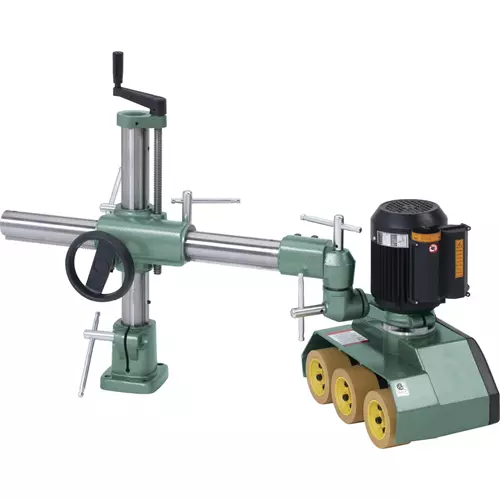

G4181 1 HP 4-Speed 3-Roller Power Feeder, Single-Phase
If you do any kind of production ripping or milling, you know what a big chore it can be feeding by hand, especially with longer and wider stock.
For those who want to increase production, upgrade, or add on another stock feeder, we have a power feeder to match virtually any application and budget.
The G4181 reduces kickback hazards and improves cutting results by feeding in a consistent and stable manner.
The universal joints allow you to adjust the power feeder tracking and height to accommodate many workpiece sizes.
The power feeder has the option to feed a workpiece at 13, 26, 33, and 66 feet per minute.
  • Motor: 1 HP, 240V, single-phase, 4.2A/2.5A
  • Feed speeds: (4) 13, 26, 33, 66 FPM
  • Rotation: Forward & reverse
  • Maximum height of rollers: 7"
  • Minimum workpiece length: 7"
  • Horizontal travel: 17"
  • Vertical travel: 9"
  • Swing: 360°
  • Rollers: (3) synthetic rubber, 2-1/4" wide x 4-5/8" dia.
  • Roller suspension: 3/4"
  • Approximate shipping weight: 141 lbs.
  • Rollers are spring-tensioned
  • Heavy-duty gear reduction with hardened gears
  • Universal positioning with handle locks
  • Rack-and-pinion horizontal movement
  • Forward/reverse feed
  • Multiple feed speeds
  • X-, Y-, Z-axis adjustment
We offer U.S.-based customer service and technical support to get your questions answered and help keep your equipment running in top condition. And to ensure your satisfaction, the G4181 comes with a 1-year warranty.
