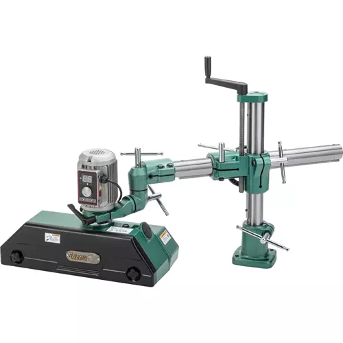

T33925 1 HP Variable-Speed 4-Roller Power Feeder, Single-Phase
A feeder with the power and speed options you need for non-stop workpiece processing.
This 4-roller power feeder is equipped with a 1 HP servo motor so you can feed boards with minimal stoppage time.
The servo motor won’t bog down, so you can run stock quickly and efficiently.
This variable-speed power feeder features speeds of 3–35 FPM and 8–90 FPM for versatility depending on your feed speed requirements.
Easily view your speed choice in either imperial or metric with the LED feed rate display; adjust the speed with the convenient dial.
You can send boards through at the push of a button in both forward and reverse as your projects demand.
A rack-and-pinion system provides smooth, methodical motion for horizontal movement, and a crank handle simplifies vertical adjustment.
The power feeder mounts easily to your shaper or table saw and can be removed just as easily.
  • Motor: 1 HP, 220V, single-phase, 3.4A
  • Feed speeds: Variable, 3–35 FPM and 8–90 FPM
  • Vertical travel: 9-13/16"
  • Horizontal travel: 17-5/16"
  • Rotation: Forward/reverse
  • Swing: 360°
  • Minimum workpiece length: 7"
  • Rollers: (4) 2-3/8" x 4-3/4"
  • Roller suspension: 11/16"
  • Maximum height of rollers: 8-1/8"
  • Footprint: 5-1/2" x 6"
  • Overall size: 43-1/2" W x 24" D x 30" H
  • Approximate shipping weight: 141 lbs.
  • Tough and effective servo motor
  • LED feed rate display showing both imperial and metric readings
  • Variable-speed adjustment dial
  • Forward/reverse feed
  • Push-button ON/OFF switch and feed direction
  • Rack-and-pinion horizontal movement
  • Crank handle vertical adjustment
  • Easy mounting and removal
