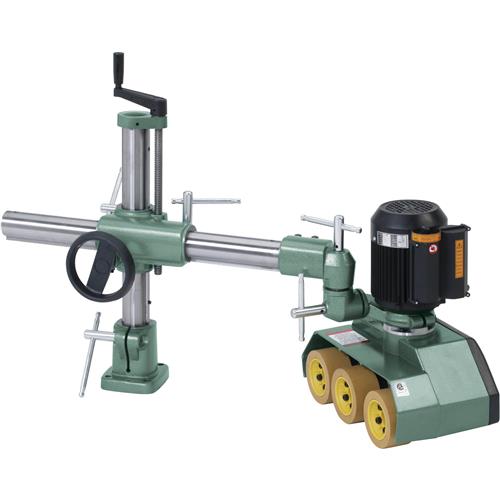

G7873 1 HP 4-Speed 3-Roller Power Feeder, 3-Phase
Reduce wobble when feeding lumber through your machines.
If you do any kind of production ripping or milling, you know what a big chore it can be feeding by hand, especially with longer and wider stock.
The G7873 allows you to smoothly and efficiently feed workpieces through your woodworking machines.
Power feeders reduce kickback hazards and improve cutting results by feeding in a consistent and stable manner.
This power feeder has the option to feed a workpiece at 13, 26, 33, and 66 feet per minute.
Most common machines these are paired with are shapers and router tables, yet can also be used with table saws, jointers, and bandsaws.
SPECIFICATIONS
  • Motor: 1 HP, 240V, 3-phase 3.4A/2.5A
  • Feed speeds: (4) 13, 26, 33, 66 FPM
  • Swing: 360°
  • Vertical travel: 9-7/8"
  • Horizontal travel: 18-1/8"
  • Rotation: Forward/reverse
  • Minimum workpiece length: 7"
  • Rollers: (3) 2-1/4" x 4-5/8"
  • Roller suspension: 3/4"
  • Maximum height of rollers: 7"
  • Overall size: 43-1/2" W x 8-1/2" D x 13" H
  • Approximate shipping weight: 144 lbs.
FEATURES
  • Rollers are spring tensioned with 3/4" of travel
  • Heavy-duty gear reduction with hardened gears
  • X-, Y-, Z-axis adjustment with handle locks
  • Rack-and-pinion horizontal movement
We offer U.S.-based customer service and technical support to get your questions answered and help keep your equipment running in top condition. And to ensure your satisfaction, the G4181 comes with a 1-year warranty.
