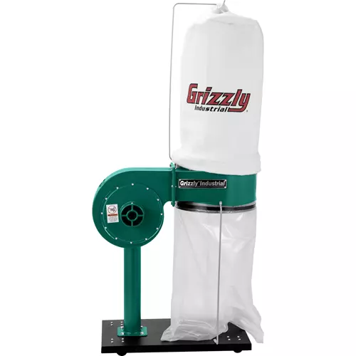

G8027 1 HP Dust Collector
An award-winning dust collector for an incredible price!
The G8027 1 HP Dust Collector was awarded Best Value by WOOD Magazine.
It is a robust, yet portable dust collector with larger collection capacity than any of our other 1 HP models.
It's perfect for collecting wood, dust, and chips from sanders, router tables, jobsite table saws, benchtop jointers and planers, and other woodworking machines.
This dust collector has air suction capacity of 500 CFM and has a max static pressure of 2.76 inches. Static pressure is produced by the 9" balanced steel, radial fin impeller to move the wood chips into the collector.
The filtration rating means it can collect particles down to 2.5-microns. For reference, a human hair is between 50–70 microns in diameter, meaning the G8027 collects particles 30 times smaller!
The G8027 excels as a point-of-use dust collector for collecting from a single machine. It is also a very portable dust collector, so you can take it to the job site where it can handle the jobs a regular shop vacuum can't handle.
Size is perfect for if you have limited space available.

  • Motor: 1 HP, 110V, single-phase, 7.4A
  • Air suction capacity: 500 CFM
  • Static pressure: 2.76"
  • Bag filtration: 2.5-micron
  • Bag capacity: 2.3 cubic feet
  • Intake hole size: 4"
  • Impeller: 9" balanced steel, radial fin
  • Upper bag size: 14-1/2" dia. x 24" D
  • Lower bag size: 14-1/2" dia. x 23" D
  • Footprint: 15" x 25-1/2"
  • Overall dimensions: 25-1/2 W x 15" L x 63" H
  • Approximate shipping weight: 58 lbs.
  • 2.5-Micron upper bag filtration
  • 9" Steel impeller
  • Powder coated paint
  • Steel base with casters for mobility
