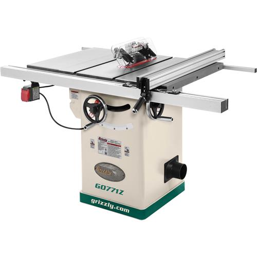

G0771Z 10" 2 HP 120V Hybrid Table Saw w/ T-Shaped Fence
The best features of the contractor and cabinet saws combined.
The G0771Z 10" 2 HP Hybrid Table Saw blends the best features of a contractor or job site table saw with the cabinet-style table saw. Like the cabinet saw, it has an enclosed cabinet, heavy-duty cast-iron trunnions that mount to the cabinet, and plenty of power to easily rip through hardwoods or cut dadoes. Like the contractor-style saw, it's still light enough to move where you need it and most importantly it's easy on the budget.
The fence on this machine is also a hybrid of the best features we've had on table saws in the last 30+ years. These all-time best features include the easiest lift-off and simple adjustability of one fence, the rock-solid front locking ability of another and the accessory T-slots of a third. The research and development put into this finished fence creates a simpler and more enjoyable user experience.
The G0771Z features an innovative quick-release blade guard and riving knife system that can be changed in seconds. A 4" dust port is integrated into the steel cabinet-type stand for maximum dust collection. The precision-ground cast-iron table exceeds 40" with the extension wings. To top it all off, it's prewired to run on an ordinary household 120V, 20A circuit!
The best option for small shops.
The G0771Z manual was written by our U.S.-based Technical Documentation Department and is packed with useful information. The complete and easy-to-read manual makes it easier to assemble and maintain your saw.
